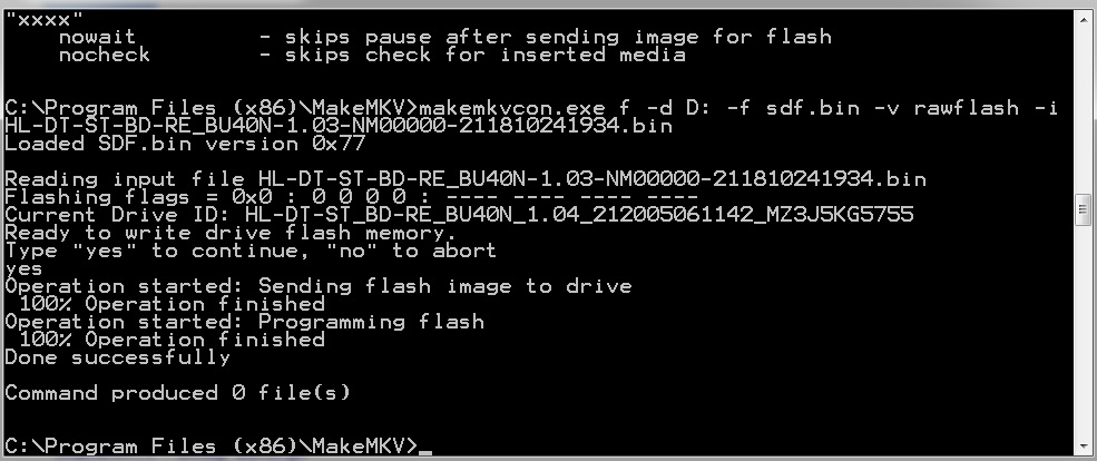

something weird just happen. Operation was successful, but firmware is still 1.04? what the heck?

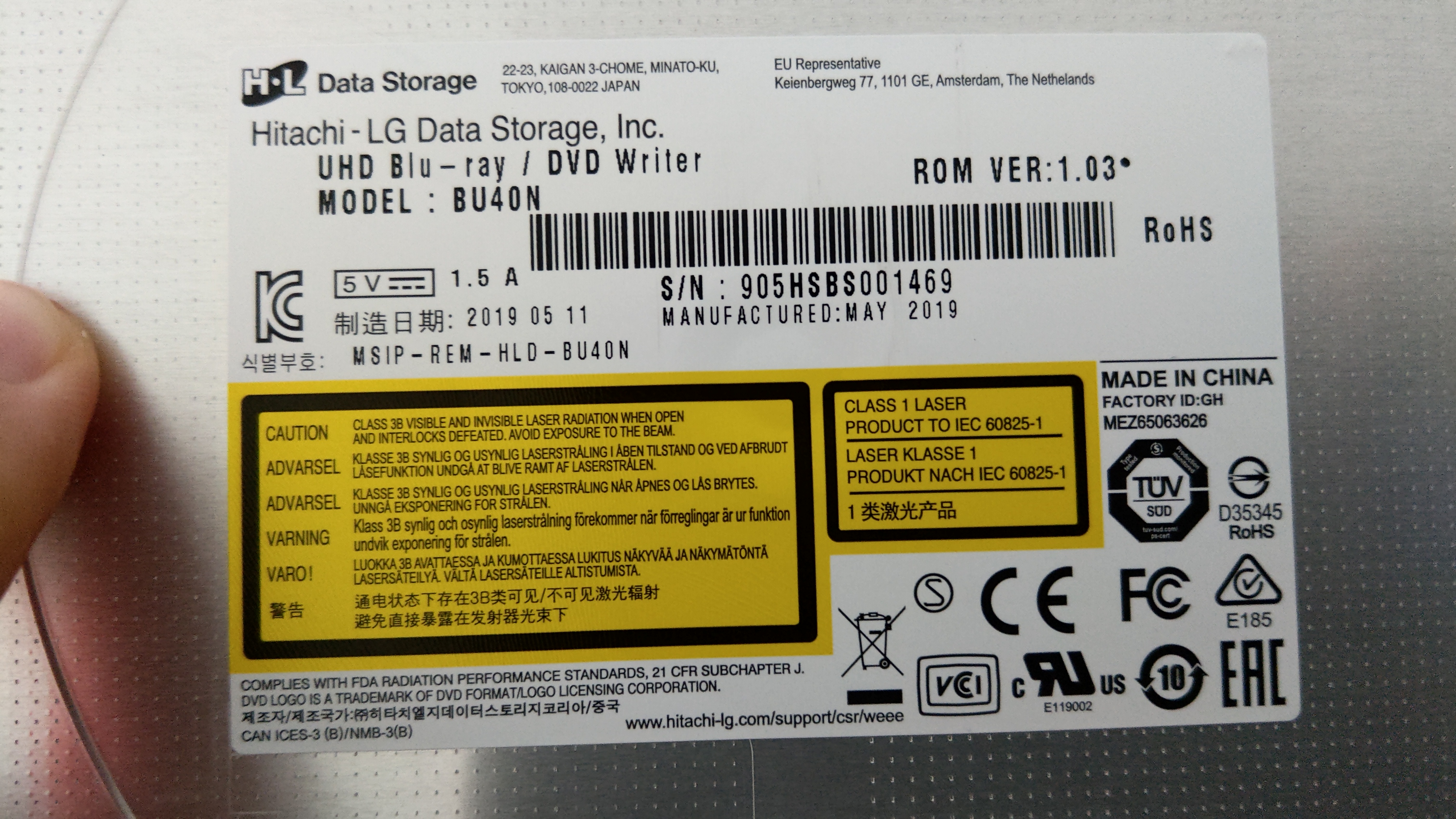

This might be a dumb question, but since it says ROM 1.03 on it (I assume manufactured with that) and has arrived to him with 1.04, does this mean they're upgrading the firmware at suppliers?

I don't see any other explanation...AffSeda wrote: Fri Jul 03, 2020 1:15 pm This might be a dumb question, but since it says ROM 1.03 on it (I assume manufactured with that) and has arrived to him with 1.04, does this mean they're upgrading the firmware at suppliers?

Put "enc" option (without quotes) after rawflash because if your unit comes with 1.04 it will accept only fw in encrypted format.

It works!TeddyRaspin wrote: Fri Jul 03, 2020 3:33 pm Put "enc" option (without quotes) after rawflash because if your unit comes with 1.04 it will accept only fw in encrypted format.

Why are the serial numbers from MakeMKV and from the sticker different?

it also makes me wonder. The drive comes from a legal distribution ... I think the distributor or supplier has changed the firmware (forcibly?). This is really strange.Ezatoka wrote: Sat Jul 04, 2020 12:00 am Unrelated question:

I'd guess the number MakeMKV is displaying is actually the serial number of the drive controller / internal device, rather than the serial of the entire unit as a whole (whats on the label).

I think they are running some sort of upgrade process (could be recall / refurbish) where the drive gets a new firmware with encryption, and changes its serial number in a process.metasynapse wrote: Sat Jul 04, 2020 11:28 am it also makes me wonder. The drive comes from a legal distribution ... I think the distributor or supplier has changed the firmware (forcibly?). This is really strange.
