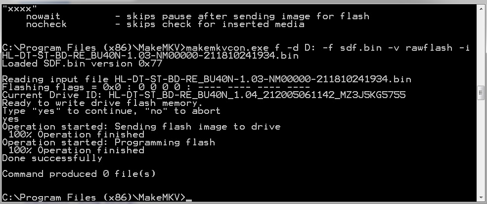

Re: BD-RE BU40N Revision: 1.04
something weird just happen. Operation was successful, but firmware is still 1.04? what the heck?
- flashing.jpg (123.55 KiB) Viewed 42783 times

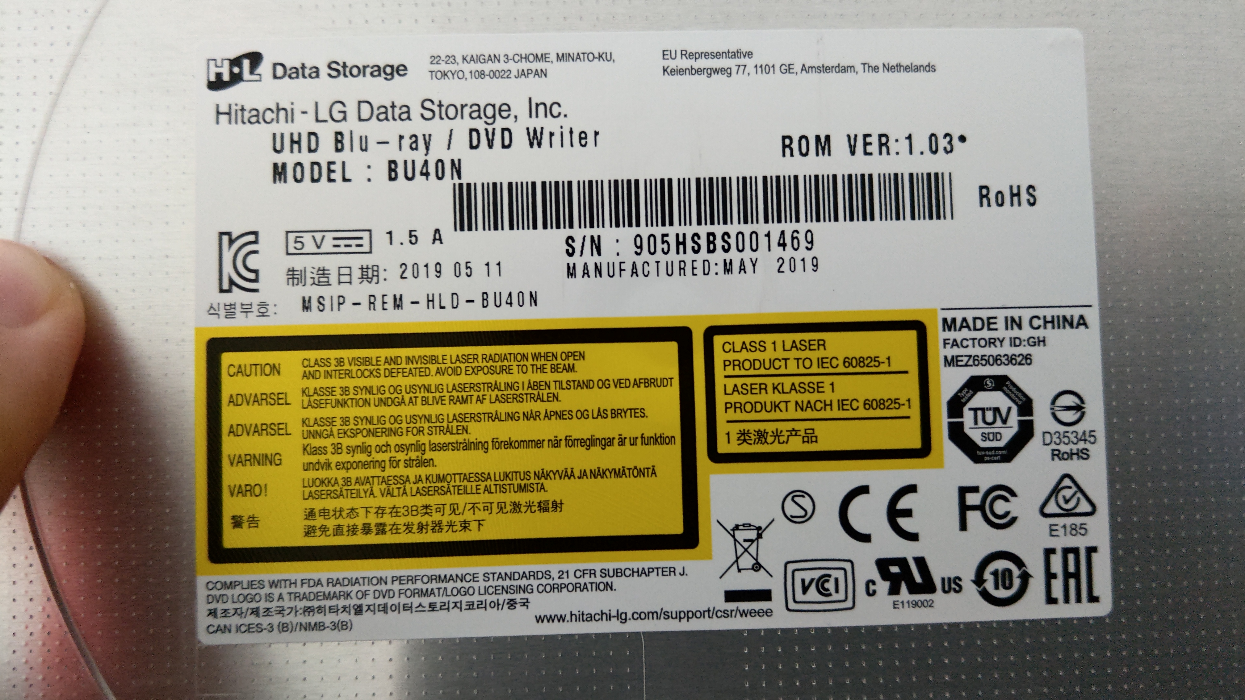

This might be a dumb question, but since it says ROM 1.03 on it (I assume manufactured with that) and has arrived to him with 1.04, does this mean they're upgrading the firmware at suppliers?
metasynapse
- Posts: 7
- Joined: Thu Jul 02, 2020 11:04 am
I don't see any other explanation...AffSeda wrote: Fri Jul 03, 2020 1:15 pm This might be a dumb question, but since it says ROM 1.03 on it (I assume manufactured with that) and has arrived to him with 1.04, does this mean they're upgrading the firmware at suppliers?
Put "enc" option (without quotes) after rawflash because if your unit comes with 1.04 it will accept only fw in encrypted format.
metasynapse
- Posts: 7
It works!TeddyRaspin wrote: Fri Jul 03, 2020 3:33 pm Put "enc" option (without quotes) after rawflash because if your unit comes with 1.04 it will accept only fw in encrypted format.
