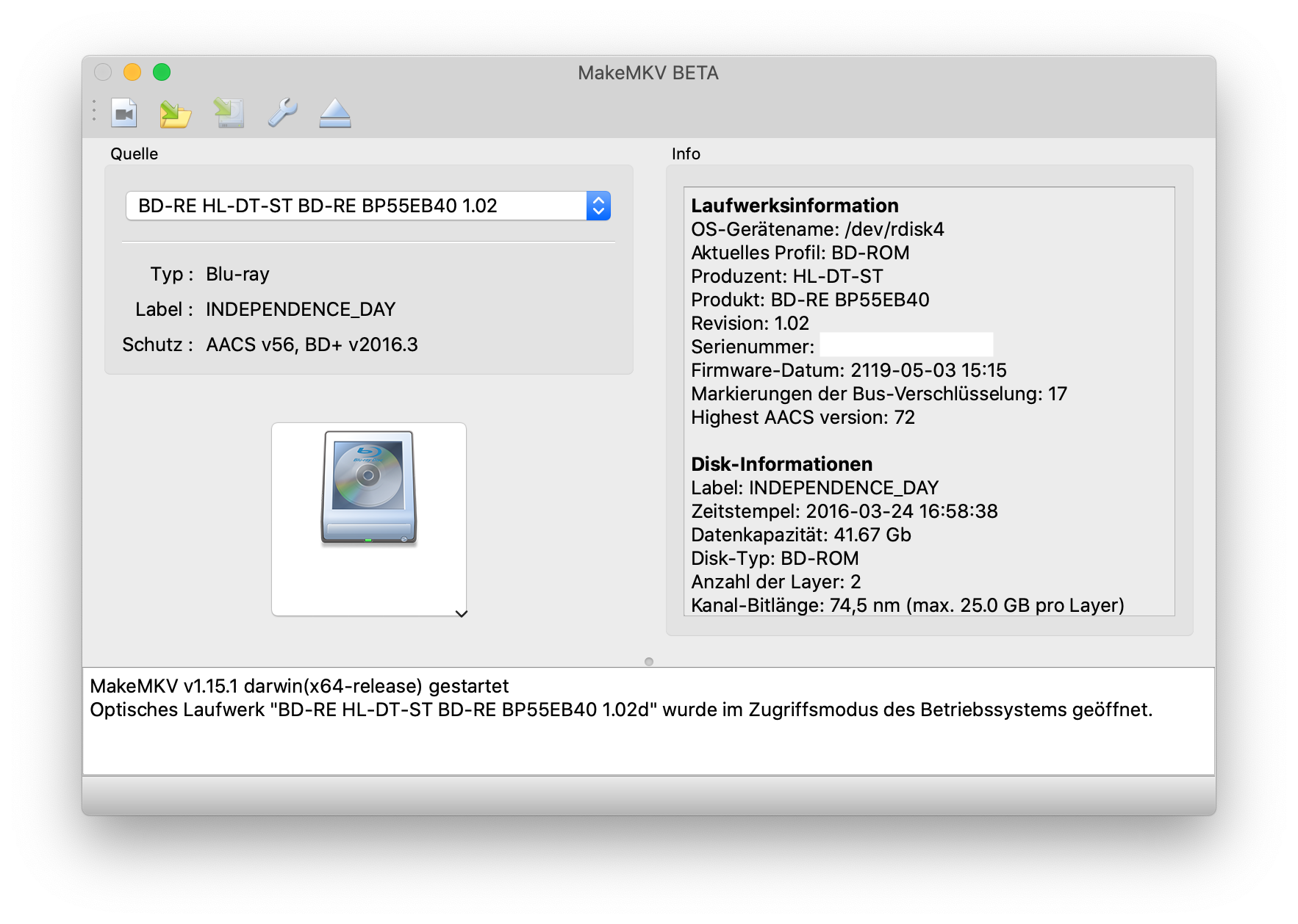

Weird thing is that MakeMKV does not show any LibreDrive information in its application window. This has happened for other people as well, although not for this specific drive and with no apparent solution. I have no clue as to why that may be. Perhaps it's related to the flashing problem? See screenshot attached.

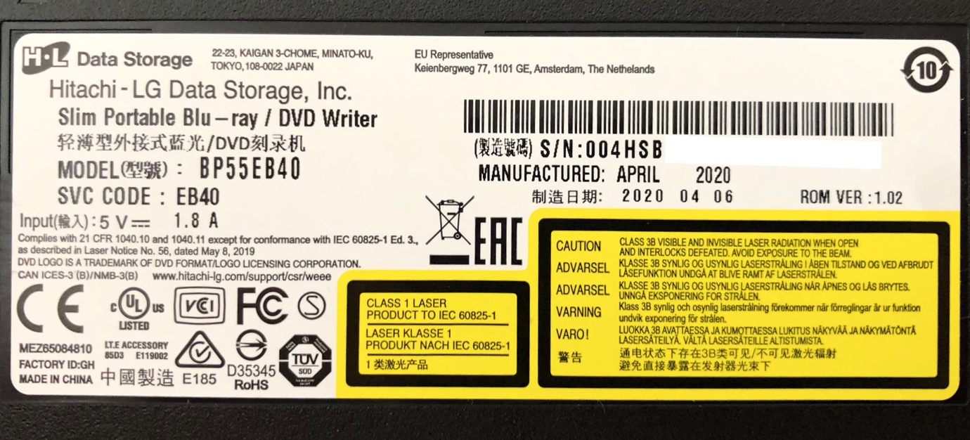

drive sticker.jpg (331.43 KiB) Viewed 44467 times

SDF.bin version: 0x0076
Drive Tool SDF not present
Drive Specific SDF not present
Identification SDF present
$ /Applications/MakeMKV.app/Contents/MacOS/makemkvcon f -v -v -v -d HL-DT-ST_BD-RE_BP55EB40_1.02_211905031515_SIK01K3ND5125 -f sdf.070.bin --info
Found sdf.bin version 0x70 at sdf.070.bin
Loaded SDF.bin version 0x70
No drive-specific logic found in SDF.bin
SDF.bin version: 0x0070
mike admin
Posts: 4107
Re: Attemping to flash LG BP55EB40 on macOS
Post by mike admin » Thu Jun 25, 2020 10:08 am
MacNick wrote: Thu Jun 25, 2020 9:53 am I re-downloaded it, renamed it "sdf.downloaded.bin" and it now identifies as v76.
You did everything right. This is a bug, sorry. Please check PM in a bit.
MacNick wrote: Thu Jun 25, 2020 9:53 am However, the application still states that no drive tool logic is contained within (what exactly does that mean?):
Some explanation is here viewtopic.php?f=19&t=18856#p72110
All flashing logic is data-driven. The flashing tool is a "program" that is embedded in sdf.bin. This way you can use the old MakeMKV and get support for latest drives in firmwares. At lest in theory.
