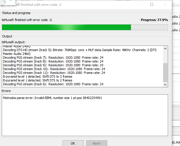

Me again with another dart throw.
I have a .mkv file already - did not create it myself, was already remuxed.
I'm trying to use this cmd:
eac3to titlename.mkv 2: titlename.thd+ac3
But constantly get "This video conversion is not supported"
I tried:
1. Remove base and extended layers with ffmpeg
2. Combine with yuescope's tool
3. Add full.hevc to TSMuxer
4. Add .mkv to TSMuxer (for audio)
However this eventually errors out with "Error 2."
Tried creating a .TS from the .mkv but also got same the error.
Annotation 2020-06-16 145448.png (28.53 KiB) Viewed 38197 times
Is there something obvious I'm missing here? The remux .mkv file has two video tracks, so figured DV would be one of those..

chrisandy wrote: Tue Jun 16, 2020 9:24 pm Me again with another dart throw.
I tried:
You're not going to find much help here if a scene release is your source material. There are just too many variables on how the mkv was initially created that can cause issues down the line. You have to get a better understanding of what each step in the process is doing if that's going to be your source. For instance, it looks like your title only has DTS audio. There's no reason to go through the eac3to step because TSMuxer can use the audio track as is. The eac3to step is only needed if you have a title with a TrueHD atmos track. Also, you were getting that eac3to error likely because the "2" in the command refers to the second track of the file, which is likely a video track.

shawnc22 wrote: Tue Jun 16, 2020 11:07 pm
I tried:
As always, appreciate the insight.
In theory, if this MKV was muxed correctly, would the straightest path be to drop it into TSMuxer and create a .TS?
Re: Dolby Vision and 1.15.1
Post by shawnc22 » Wed Jun 17, 2020 1:21 am
mathias19 wrote: Wed Jun 17, 2020 12:44 am I've done what you suggested and created the MP4 with the base layer, enhanced layer and AC3. However my LG does not play from the attached USB drive. In mediainfo the file shows 2 seperate video streams plus the AC3 audio. One is HDR 10 and the second shows the dolby vision. Is this correct?
Can you post the mediainfo? And by "does not play", do you mean nothing happens at all when you try playing the file, the file can't be seen at all, or either video/audio not working?
chrisandy wrote: Wed Jun 17, 2020 1:00 am As always, appreciate the insight.
There's not really such a thing as "muxed correctly". As far as MKVs are concerned, I'm sure they will all play just fine in HDR10, which is their intended purpose. But for what you're trying to do, you need the MKV to be made under a specific condition, which is makemkv 1.15.1. Any other method will either require additional processing (yusecope's tool) or just not work at all.

As other people have said, are you sure 2 is actually the THD track in this file?
Try DVDfab uhd creator to create a M2TS.
