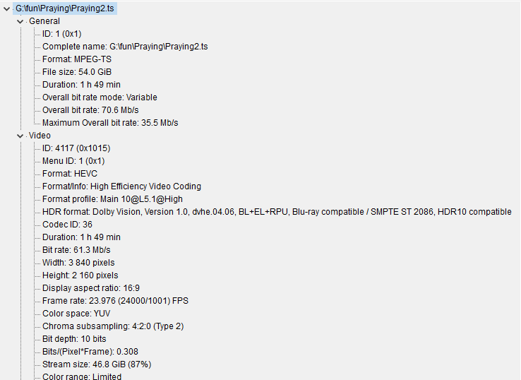

Unfortunately still both unable to change the level # and I'm still only getting HDR10 instead of DV.
Here is my set up:
Apple TV 4K
Infuse App
Here is what I am doing:
Use Yuescope's tool to extract Base Layer and Extended Layer
Add those to TSMuxer
Add playlist file to TSMuxer
Remove the two video files from the playlist file, leaving the .hevc and the audio files
Create a .m2ts file
That .m2ts checks out in Mediainfo but it does not play as Dolby Vision in the Infuse app.
Are you using -mode 2 with Yuescopes tool?
You must to create a profile 5 compliant file.
I did use -mode 2. I am/was unable to figure out how to create a profile 5 compliant file though.

jesus... just mux it with version I linked.... you don't need to change "level" in tsMuxer.

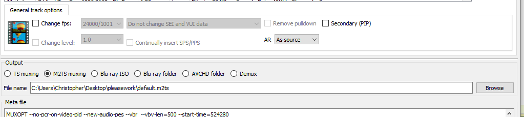

chrisandy
Posts: 60
Post by chrisandy »
jlpsvk wrote: Thu Jun 04, 2020 10:53 pm jesus... just mux it with version I linked.... you don't need to change "level" in tsMuxer.
Thanks - I realized my error soon before you posted :-)
Annotation 2020-06-04 225541.png (33.36 KiB) Viewed 32613 times
jlpsvk
Posts: 50
Joined: Thu Sep 06, 2018 11:33 am
Post by jlpsvk »
chrisandy wrote: Fri Jun 05, 2020 3:38 am
you need to use BL+RPU, not BL+EL+RPU (MODE 2 of tool)
