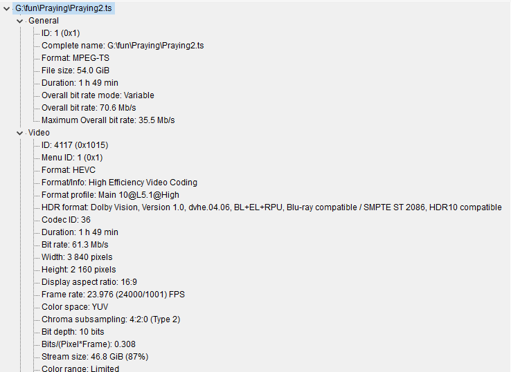

#604
Post
by chrisandy » Fri Jun 05, 2020 4:26 am
- Annotation 2020-06-04 225541.png (33.36 KiB) Viewed 45195 times

Post
by SamuriHL » Fri Jun 05, 2020 11:42 am
Is it a shield tube or pro?

by chrisandy » Fri Jun 05, 2020 3:09 pm
Shield Pro.

by SamuriHL » Fri Jun 05, 2020 4:05 pm
Should be playing back smooth. I know others have had issues previously but I don't remember what the cause was.

by shawnc22 » Fri Jun 05, 2020 4:46 pm
chrisandy wrote: Fri Jun 05, 2020 3:09 pm
Shield Pro.
SamuriHL wrote: Fri Jun 05, 2020 11:42 am
https://mega.nz/file/YSxhkSLK#fkfy54tYV ... xIOBZLyGR4
Give that sample a try. If it works with Atmos+DV, then something's wrong with your remux process. If you're still encountering playback issues, then it's something with your setup.

by chrisandy » Fri Jun 05, 2020 5:09 pm
shawnc22 wrote: Fri Jun 05, 2020 4:46 pm
Shield Pro.
Thanks very much. This worked fine.
I used the nightly TSMuxer to demux into the base + extra layer and yuescope's v4 tool to create the single layer, followed by TSMuxer again to create the .ts, however yuescope's v4 was GUI based so I didn't see a way to specify double vs single layer.
Just want to confirm if the issue could be lying with how I originally demuxed or how I created the single .hevc?
P.S. I also created a .m2ts file using the same muxing method and a few minutes in that has not given me any stuttering issues.

by chrisandy » Sun Jun 07, 2020 5:29 am
chrisandy wrote: Fri Jun 05, 2020 5:09 pm
Just want to add to this - I created a .ts file for another video using ffmpeg instead of TSmuxer to demux and created the rest of the files the same way. The resulting .ts file stutters, while the .m2ts does not. I tried hard wiring the Shield to rule out a network issue as well.
