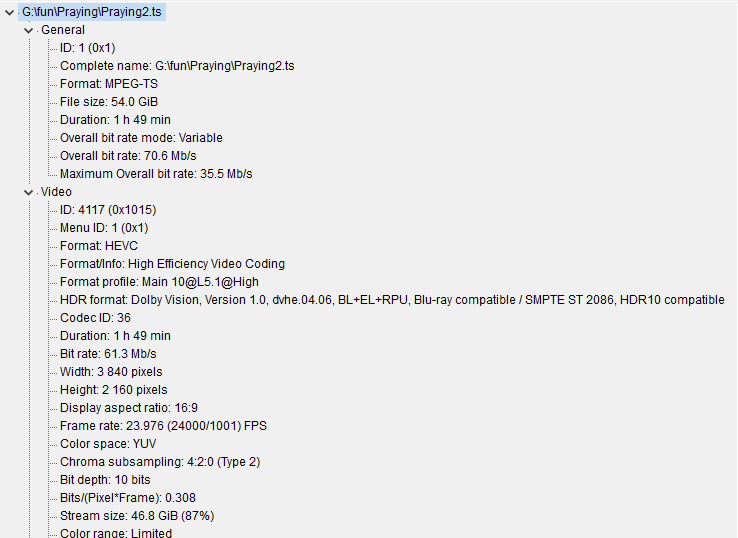

Annotation 2020-06-04 225541.png (33.36 KiB) Viewed 46576 times

I used the nightly TSMuxer to demux into the base + extra layer and yuescope's v4 tool to create the single layer, followed by TSMuxer again to create the .ts, however yuescope's v4 was GUI based so I didn't see a way to specify double vs single layer.
Just want to confirm if the issue could be lying with how I originally demuxed or how I created the single .hevc?
P.S. I also created a .m2ts file using the same muxing method and a few minutes in that has not given me any stuttering issues.
Just want to add to this - I created a .ts file for another video using ffmpeg instead of TSmuxer to demux and created the rest of the files the same way. The resulting .ts file stutters, while the .m2ts does not. I tried hard wiring the Shield to rule out a network issue as well.
