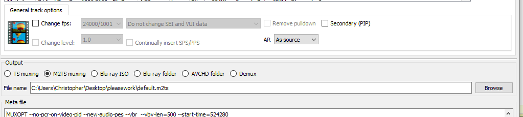

Trying to achieve this but unfortunately level is grayed out for me - is there something obvious I am missing?
Annotation 2020-05-31 232956.png (14 KiB) Viewed 33148 times

chrisandy wrote: Mon Jun 01, 2020 6:36 am
Don't download latest nigthly of tsMuxer, but this one:
https://bintray.com/justdan96/tsMuxer/tsMuxerGUI-Nightly/2020-03-30--02-11-36#files
it will create dvhe.05 instead dvhe.06... :)

chrisandy
Posts: 60
Post by chrisandy »
jlpsvk wrote: Mon Jun 01, 2020 10:31 am

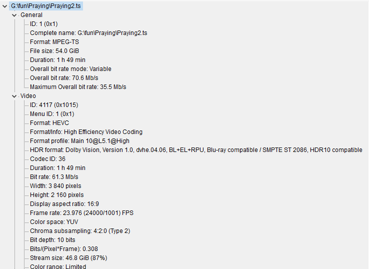

Unfortunately still both unable to change the level # and I'm still only getting HDR10 instead of DV.
Here is my set up:
Apple TV 4K
Infuse App
Here is what I am doing:
Use Yuescope's tool to extract Base Layer and Extended Layer
Add those to TSMuxer
Add playlist file to TSMuxer
Remove the two video files from the playlist file, leaving the .hevc and the audio files
Create a .m2ts file
That .m2ts checks out in Mediainfo but it does not play as Dolby Vision in the Infuse app.
Annotation 2020-06-01 123108.png (24.64 KiB) Viewed 33898 times
Here is my set up:
Apple TV 4K
Infuse App
Create a .m2ts file
Are you using -mode 2 with Yuescopes tool?
You must to create a profile 5 compliant file.
