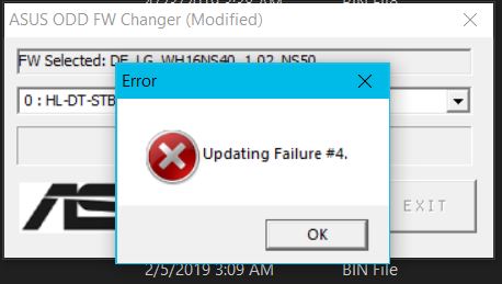

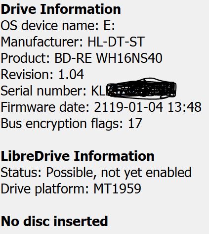

Hi all,
I purchased a new WH16NS40 (drive info attached). I also purchased this USB/SATA adapter https://www.amazon.com/gp/product/B06WW ... UTF8&psc=1
When I tried to flash the DE_LG_WH16NS40_1.02_NS50.bin included in the zip, the drive bay opens up and I get flash error #4. Would appreciate any help on what I'm doing wrong and what would be the correct way to flash this drive.

Flash WH16NS60 1.02mk first or keep it if you likefederalist wrote: Mon May 25, 2020 1:45 pm Hi all,
All that info and more in the uhd guide

Thanks for the quick reply! I missed that step first time.Billycar11 wrote: Mon May 25, 2020 11:32 pm Flash WH16NS60 1.02mk first or keep it if you like
Everything works great now
