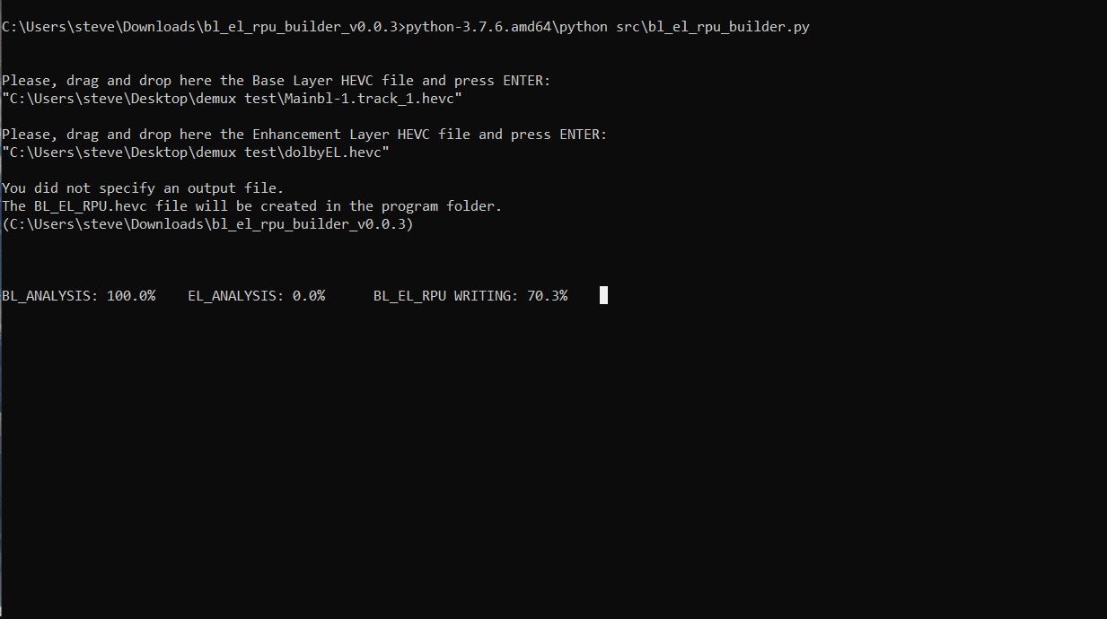

That's the version of tsmuxer that most have been using. For the last step, just load in yusecope's resulting HEVC file and then the original mpls file, uncheck the two original hevc tracks, and mux. If this doesnt work, you might want to also try the newer mkv method.
So I tried again with that version of tsMuxer, and it didn't work... Then I thought to try it again but on a different computer, and it works without any issues! I don't know what it is that it doesn't like about the first computer, both are Intel, one is a 7th gen i5, the other a 10th gen i5. I hate computers... Thanks for all your help!
