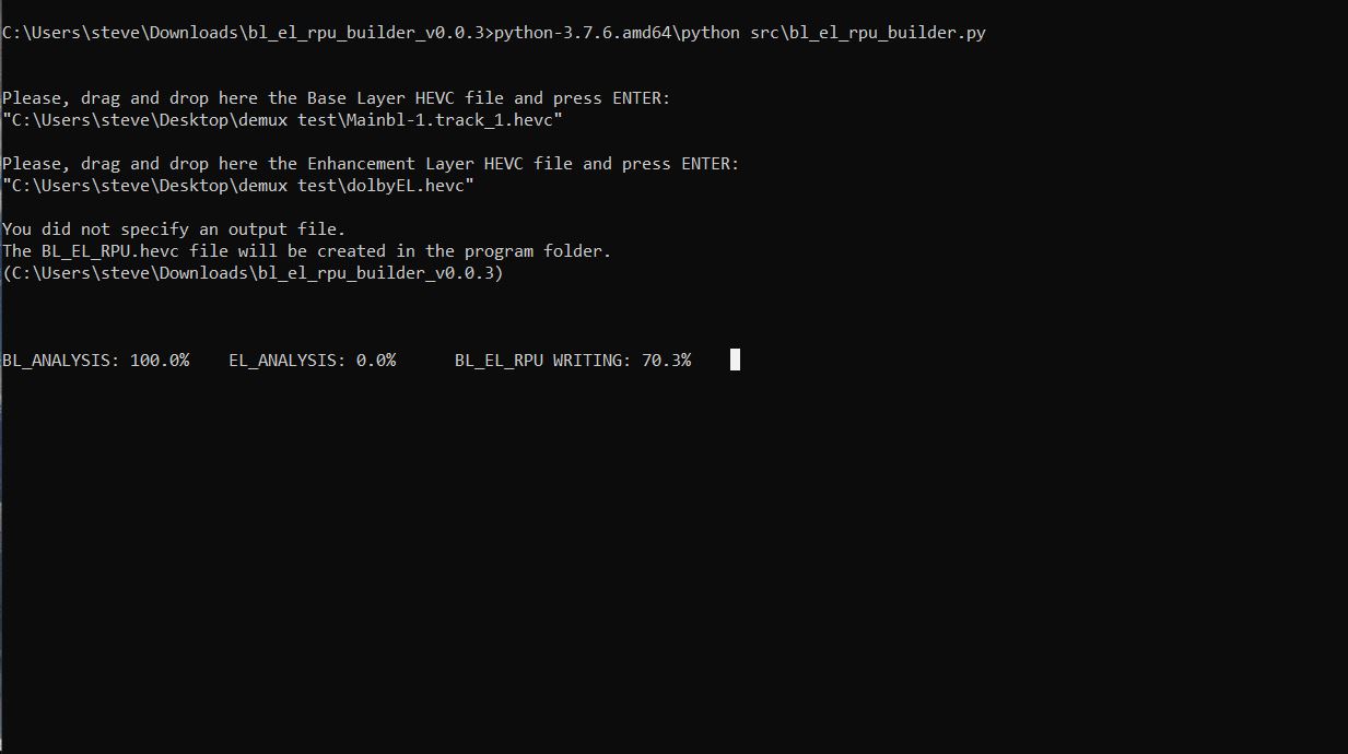

stephon1024 wrote: Sat May 23, 2020 3:57 pm Is there anyway to use handbrake to compress the base file before using your special tool?
For this type of experiment, I recommend using the 0.0.4 alfa version of my tool.
You're right when you say "it's the EL where all the DV info lives" but keep in mind that the info contained in EL are "calibrated" on those inside BL.
If you re-encode BL, logically, you should also modify EL.
No one has yet reversed the algorithm needed to generate new RPU metadata (and, in the case of FEL layers, new frames).
Imagine a guy (BL layer) with a weight of 180Kg who, after following a diet, reaches a body weight of 80Kg.
His clothes (EL layer) are now unusable but the clothing stores (the algorithm) are closed due to the quarantine.
The guy will be forced to use his old clothes.
He will always have clothes on but his style will be a little "sui generis".

Hey yusesope, thanks so much for the quick response. really appreciate the help. I will try using the latest alfa version of the tool and report back.
Anyway, thank you again for all the hard work you've put in to the tool... it's freakin awesome.
