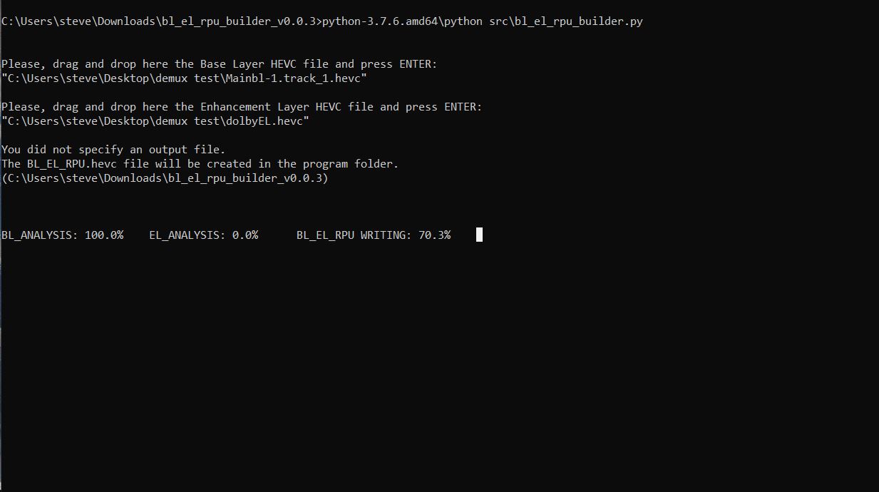

stephon1024
Posts: 14
Joined: Thu May 21, 2020 8:30 pm
Post by stephon1024 » Sat May 23, 2020 3:57 pm
First off, yusesope, thanks so much for this tool!!!
Is there anyway to use handbrake to compress the base file before using your special tool?
I've been doing it in handbrake then using Tsmuxer to extract the hevc file - but when I pop it in the tool it only starts analyzing and building the base layer and ignores the enhancement layer...
Wondering if I'm missing something. For all intents and purposes the handbraked version of my base layer should be identical to the larger one (except for size obviously) it's HEVC Main 10 level 5.1... etc. Even used handbrake to put in the appropriate HDR metadata tags, etc. This is what the tool looks like when it's done:
Like I said before yusesope, you're the best! Such a cool tool you created...
Posts: 10957
Post by Woodstock » Sat May 23, 2020 4:08 pm
stephon1024 wrote: Sat May 23, 2020 3:57 pm I've been doing it in handbrake then using Tsmuxer to extract the hevc file - but when I pop it in the tool it only starts analyzing and building the base layer and ignores the enhancement layer...
Handbrake does not handle HDR, let alone DV, so you lose the color mapping.
Also, if you compress the main video track, the hints in the DV track would no longer be valid.
stephon1024
Posts: 14
Post by stephon1024 » Sat May 23, 2020 4:16 pm
Woodstock wrote: Sat May 23, 2020 4:08 pm
Hey Woodstock, the EL i've already separated from the MakeMKV backup. So I had both streams, base and enhancement - are you saying that even though I have a base layer and a EL, there is still DV info on that base layer? That would make sense if true, but I was under the impression that there isn't anything special about the base layer, it's the EL where all the DV info lives. So shouldn't I be able to compress the base layer without removing the DV info? Then just use yusesope's tool to add the DV EL back?
It was an attempt... The massive BL_EL_RPU file that I created plays on my LG C9 but it stutters like mad making me think it's too much for the SOC on the C9 to handle. I get the DV tag showing up in the upper right and it looks amazing... just doesn't play right. This is my attempt to lower the overall bitrate of the stream
