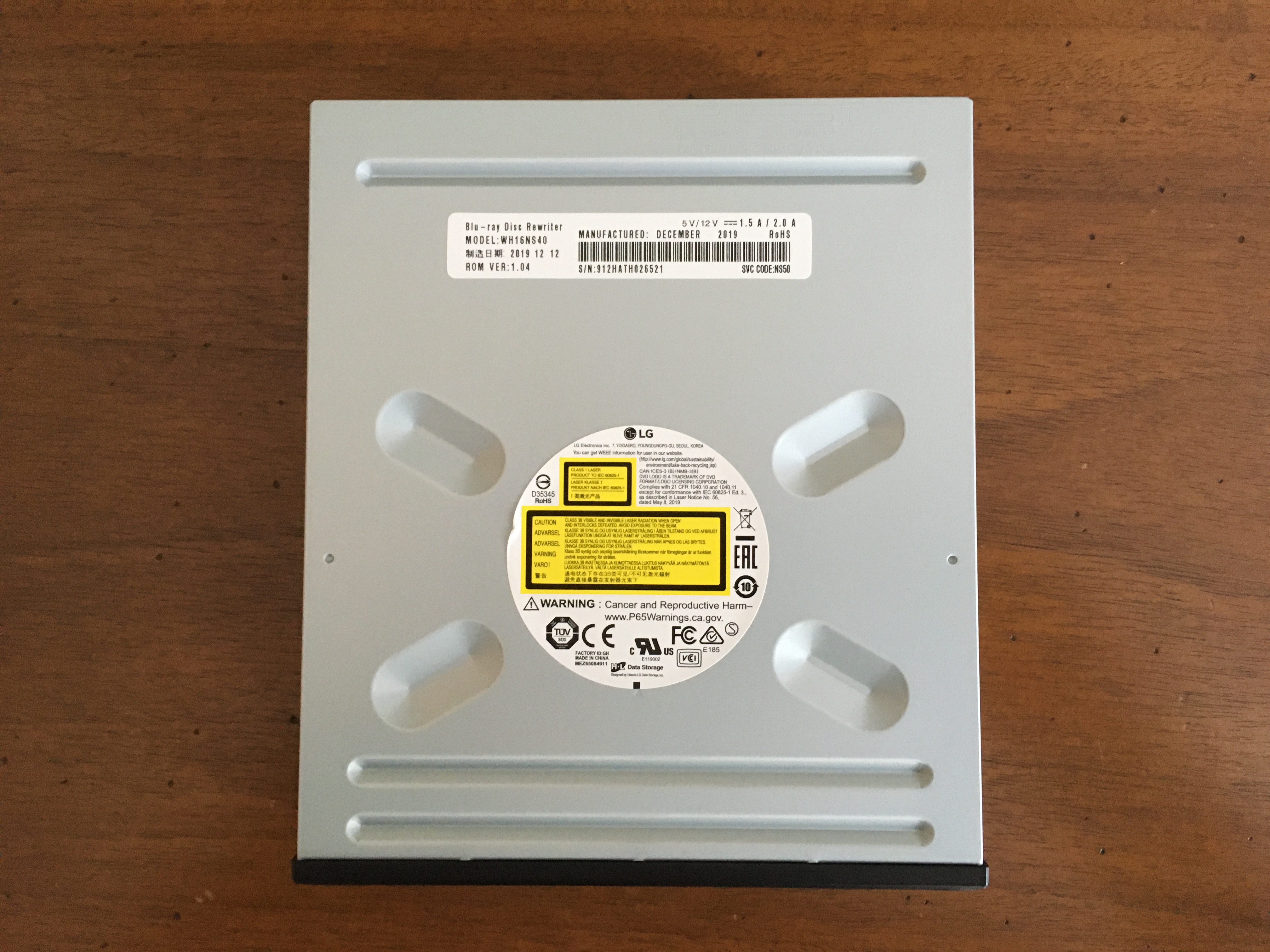

Hi, I just received my LG WH16NS40 NS50. It's a 1.04 manufactured on December 2019
I want it to be working with AnyDVD HD.
Can anyone provide me with a small explanation and download links as to how I should proceed for the flashing?
Please remember, it has to work with AnyDVD HD. :)
regards,
Danny
