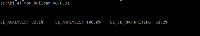

Does yusesope's tool only work for FEL or also for MEL? With FEL i've no problem but with MEL is always stuck like this:https://www.makemkv.com/forum/download/ ... ew&id=2661
Annotazione 2020-05-10 164538.png (4.03 KiB) Viewed 47682 times

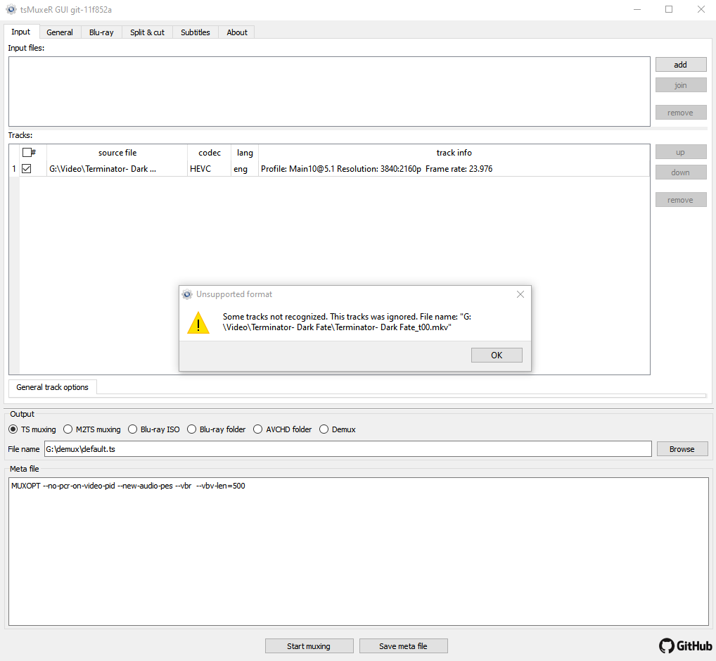

Hi, I converted the video via MakeMKV and added it to tsMuxer, video not recognized. Where is the problem?
Komentár 2020-05-10 232519.png (35.9 KiB) Viewed 47636 times

Kolci wrote: Sun May 10, 2020 9:32 pm Hi, I converted the video via MakeMKV and added it to tsMuxer, video not recognized. Where is the problem?
Your picture clearly shows the video track is definitely recognized. It's the audio that wasn't added. Please read this thread. It's been explained.
