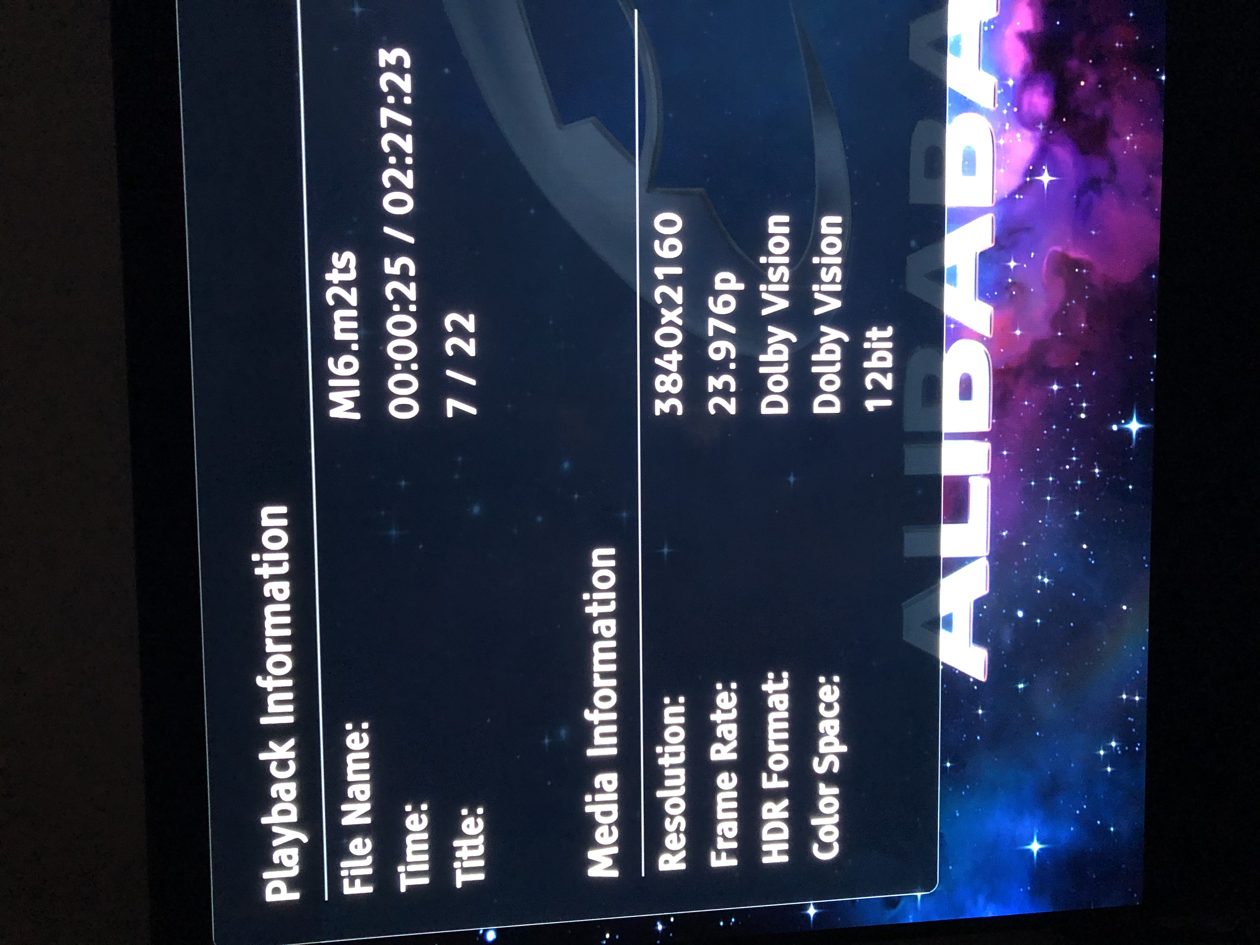

DaMacFunkin wrote: Sat Mar 28, 2020 7:35 am Hi, can confirm this mux of 1917 that didn’t work on the Oppo works in Dolby Vision and Atmos on 2019 shield pro, shame I will have to have 2 muxes of some FEL movies till it’s sorted, particularly because the Oppo is a better picture, the Colours are more balanced.
Is there any other way to try and mux so we get a file that works on both?
Regards.
I'm sorry but at the moment I don't have any other ideas.
The strange thing is that the video bit rate of 1917 is 0kbps.
If the cobination of my tool + tsMuxeR worked for Mission Impossible, it may also work for other FEL titles.
You should make some attempts.
I thank those who have tried the files that I modified (by patching the output of FFmpeg ) but at the moment the whole process consumes too much time (so it is useless).

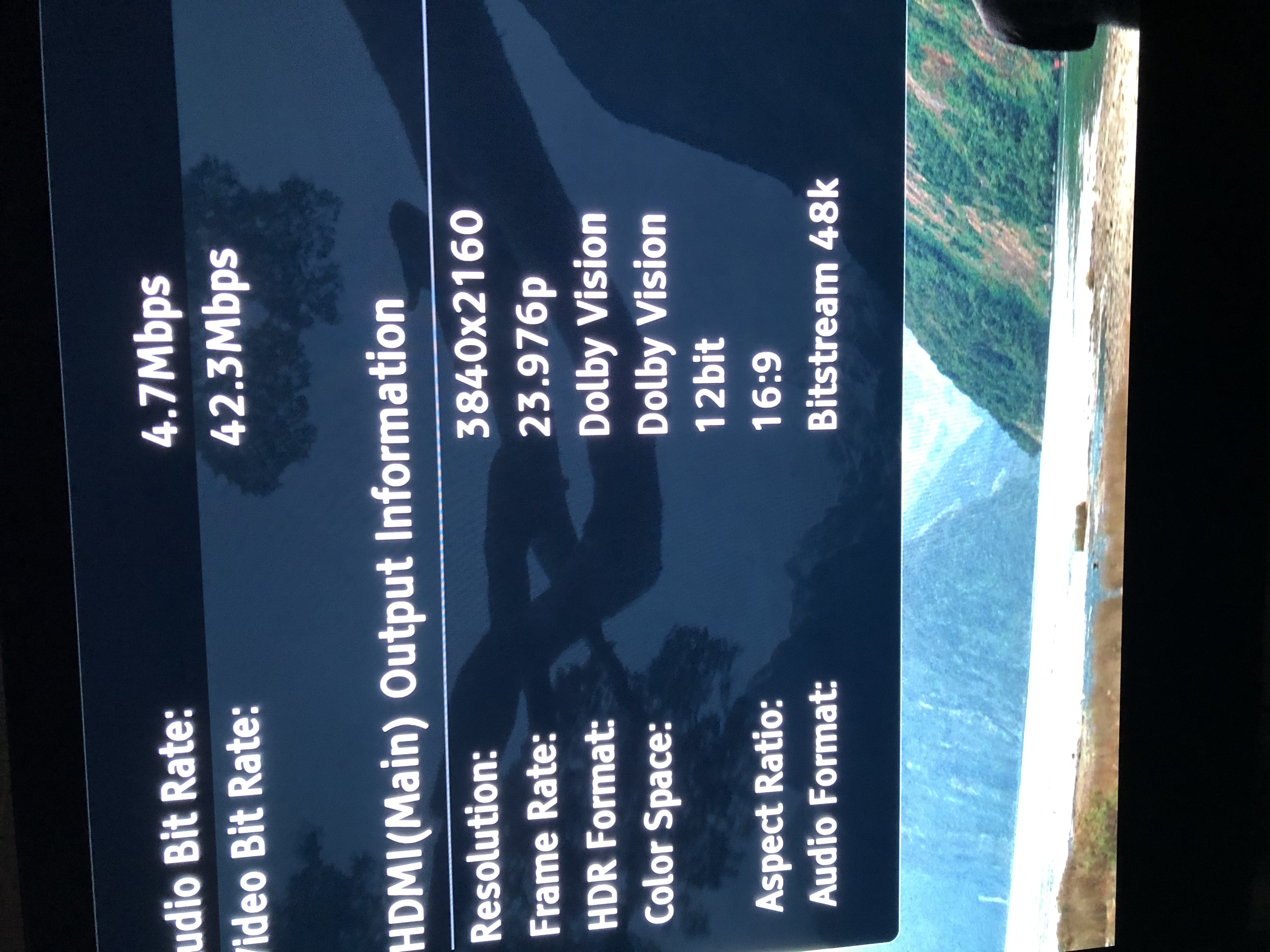

I did 1917.m2ts DV using your tool and tsmuxer.
It plays perfectly in Shield 2019 and this is the mediainfo:
HDR format : Dolby Vision, Version 1.0, dvhe.04.06, BL+EL+RPU / SMPTE ST 2094 App 4, Version 1, HDR10+ Profile B compatible
Bit rate : 82.6 Mb/s
