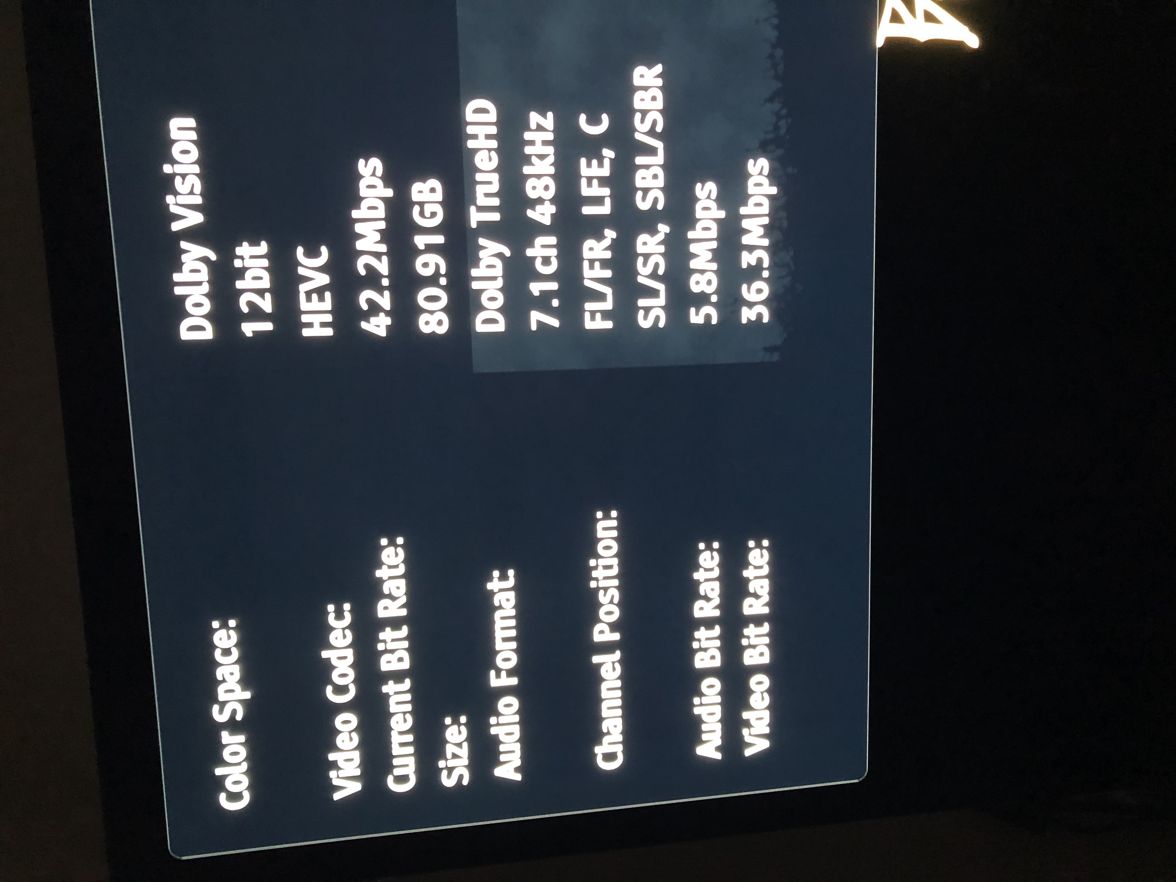

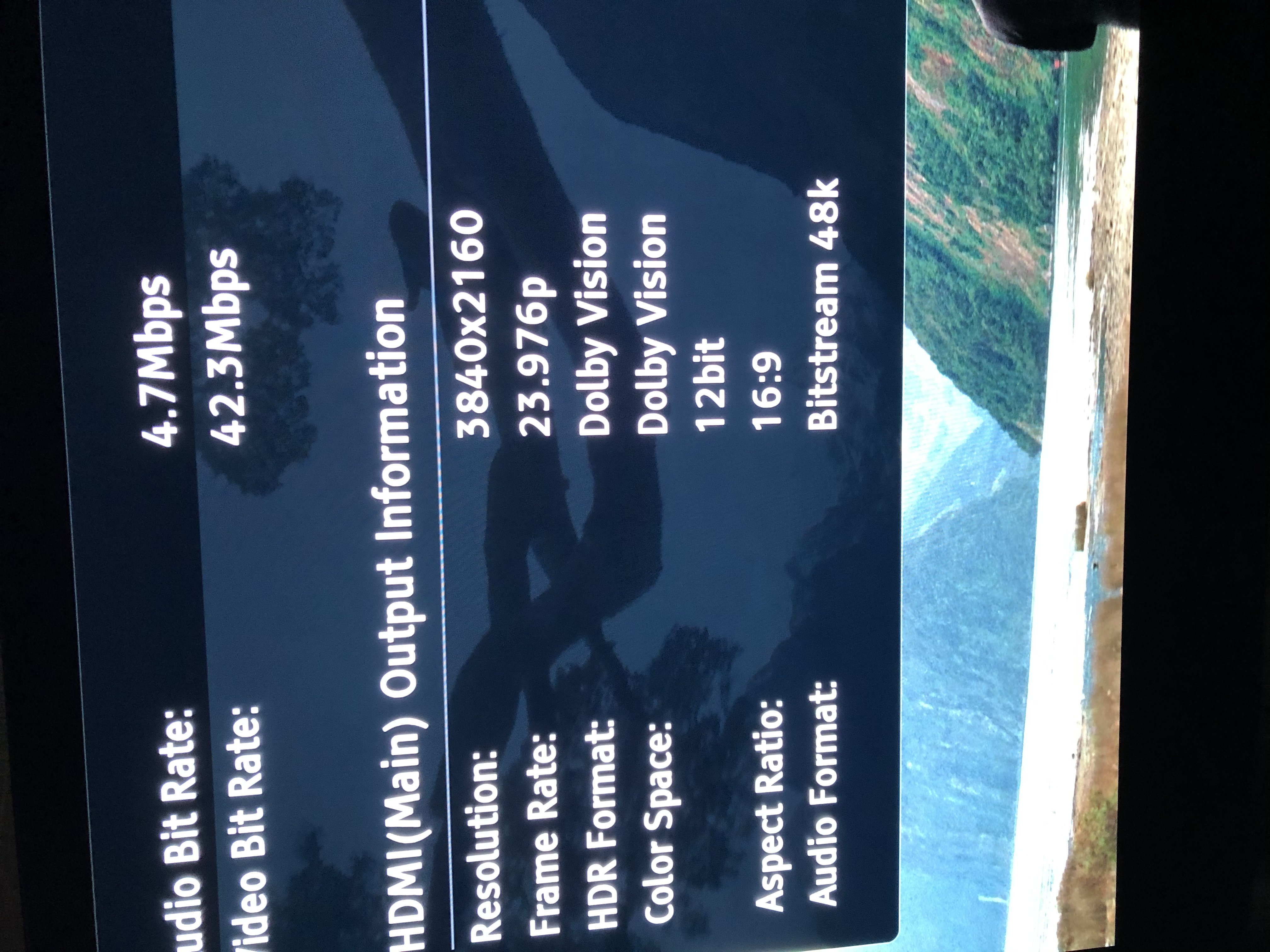

yusesope wrote: Tue Mar 24, 2020 12:17 pmThanks for trying.DaMacFunkin wrote: Sun Mar 22, 2020 9:17 pm Hi, Following the guide can't get FEL to work on the oppp, the file does work in HDR10 on the 2017 shield, can't check on the 2019 shield as it is at my weekend address (won't be there again till Friday)…
If you have time, could you please try what follows with a MEL movie?Hi Yusesope, here are the shots from the Oppo, 1917 that won’t play and reports as 8bit output, which makes sense and Missin Impissibke Fallout which plays fine, both are supposed to be FEL.yusesope wrote: Sun Mar 22, 2020 10:45 am Since you own an OPPO 203, could you do me this favour: while playing a movie (my tool + tsMuxer, please try both a FEL and an MEL movie), can you press the "info" button and take a screenshot (both for the Multimedia information section and for the HDMI output information section)?
It is important, however, that in the player settings, Color Space and Color depth (Video Output Setup) are set to AUTO.
Help yourself with this video (19:24):
https://youtu.be/Pqg8Ky6T7vc?t=1164
Thank you

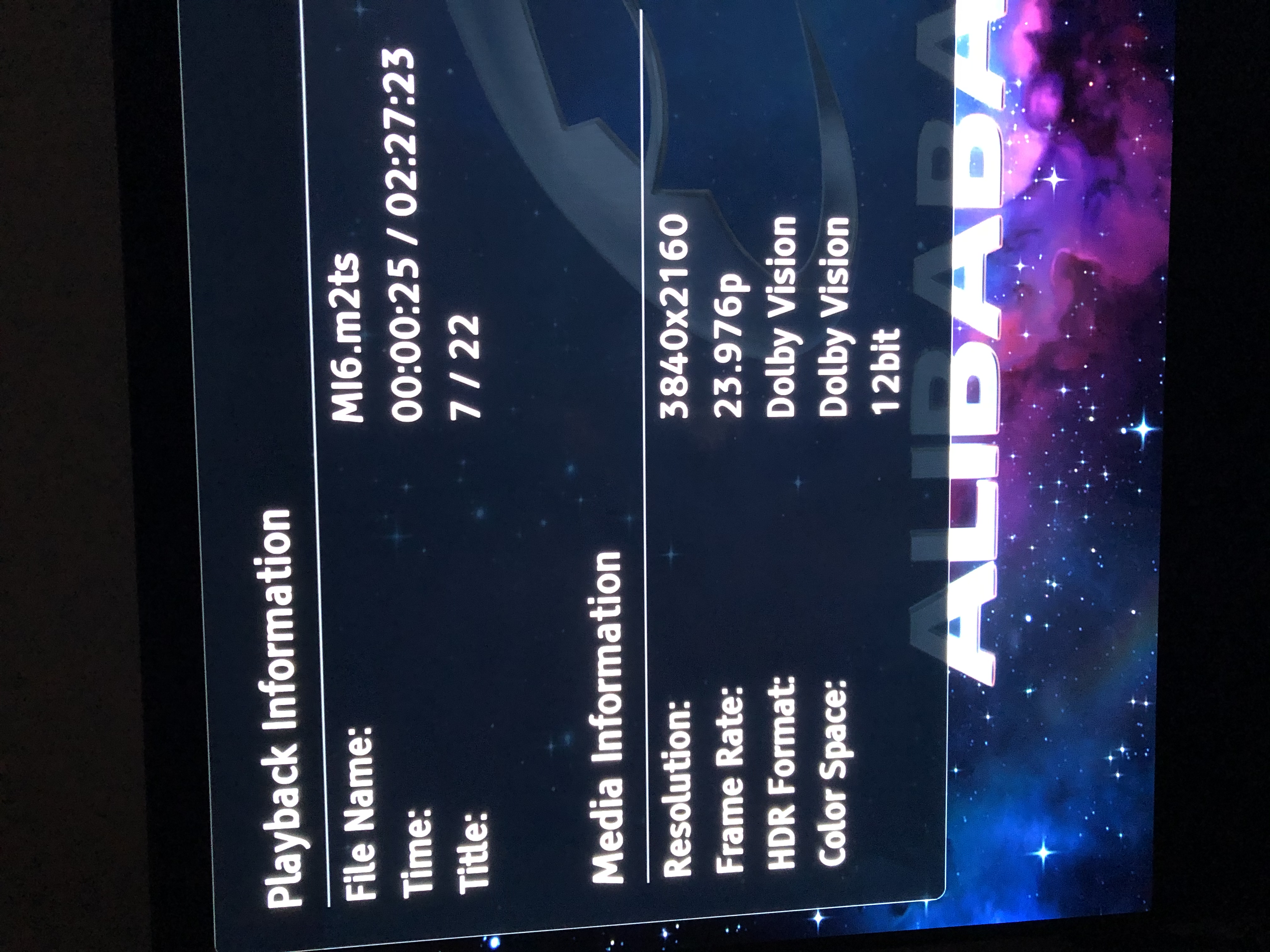

DaMacFunkin
- Posts: 314
- Joined: Tue Oct 30, 2018 4:17 pm
DaMacFunkin wrote: Thu Mar 26, 2020 7:21 pmHere are the Mission Impossible Fallout picsyusesope wrote: Tue Mar 24, 2020 12:17 pmThanks for trying.DaMacFunkin wrote: Sun Mar 22, 2020 9:17 pm Hi, Following the guide can't get FEL to work on the oppp, the file does work in HDR10 on the 2017 shield, can't check on the 2019 shield as it is at my weekend address (won't be there again till Friday)…
Thank you
- 699D3365-24A1-42DF-8FD6-28F06588EBE0.jpeg (2.96 MiB) Viewed 37208 times
- D493221A-41F0-4E2E-A9B7-5DC2AB70FF14.jpeg (2.48 MiB) Viewed 37208 times
- 8CC14F00-3083-4BF4-BD63-59822F2F0D01.jpeg (2.94 MiB) Viewed 37208 times
1917 worked great after ripping the BL, EL with TSMuxer, and using Profile 5 with MP4Muxer. It was, hands down, the best visual experience I've had in terms of Dolby Vision. Everyone that has DV needs to see it.

DaMacFunkin wrote: Thu Mar 26, 2020 7:21 pmHi, can confirm this mux of 1917 that didn’t work on the Oppo works in Dolby Vision and Atmos on 2019 shield pro, shame I will have to have 2 muxes of some FEL movies till it’s sorted, particularly because the Oppo is a better picture, the Colours are more balanced.yusesope wrote: Tue Mar 24, 2020 12:17 pmThanks for trying.DaMacFunkin wrote: Sun Mar 22, 2020 9:17 pm Hi, Following the guide can't get FEL to work on the oppp, the file does work in HDR10 on the 2017 shield, can't check on the 2019 shield as it is at my weekend address (won't be there again till Friday)…
Thank you
Is there any other way to try and mux so we get a file that works on both?
