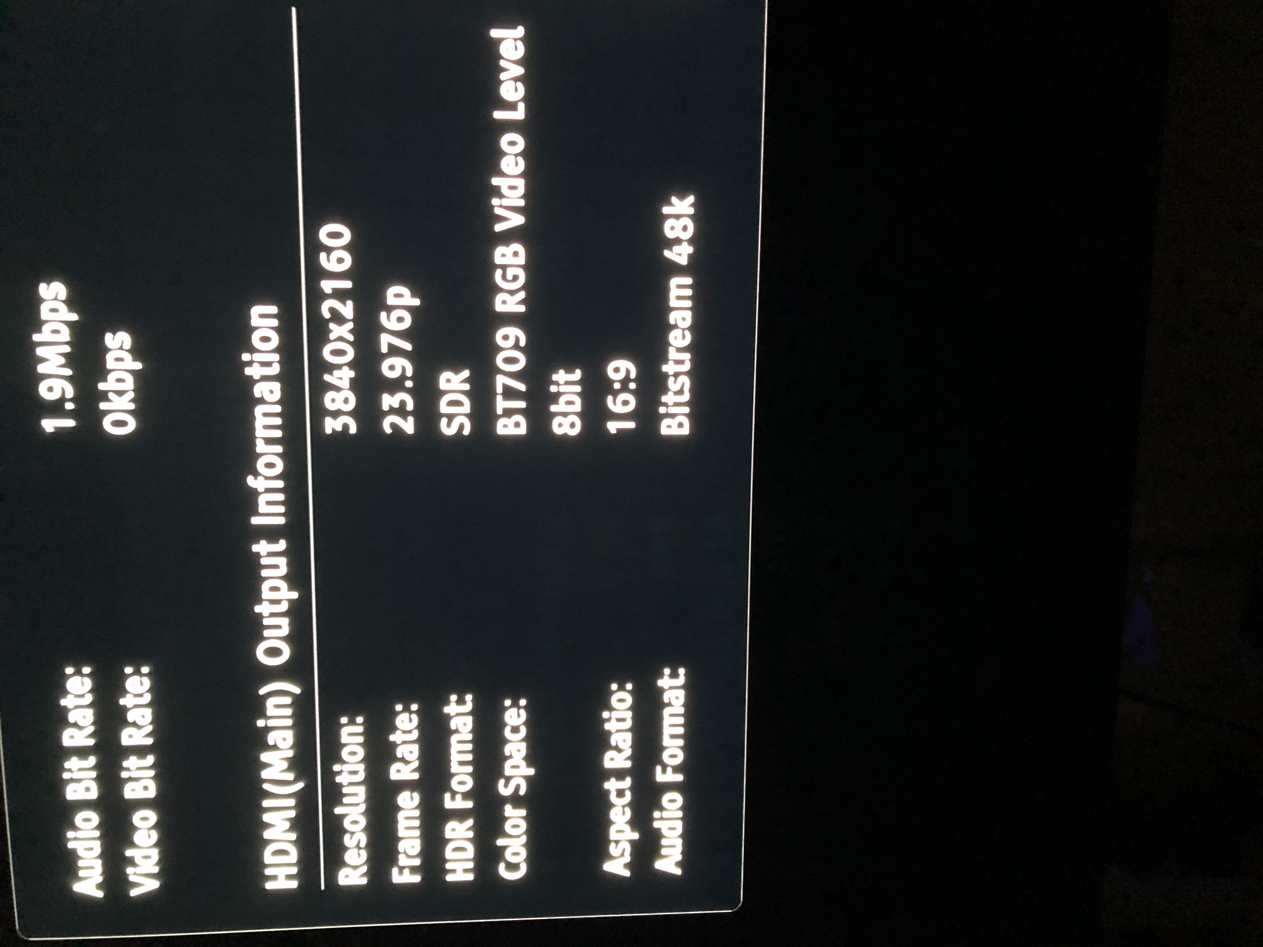

Hi Yusesope, here are the shots from the Oppo, 1917 that won’t play and reports as 8bit output, which makes sense and Missin Impissibke Fallout which plays fine, both are supposed to be FEL.

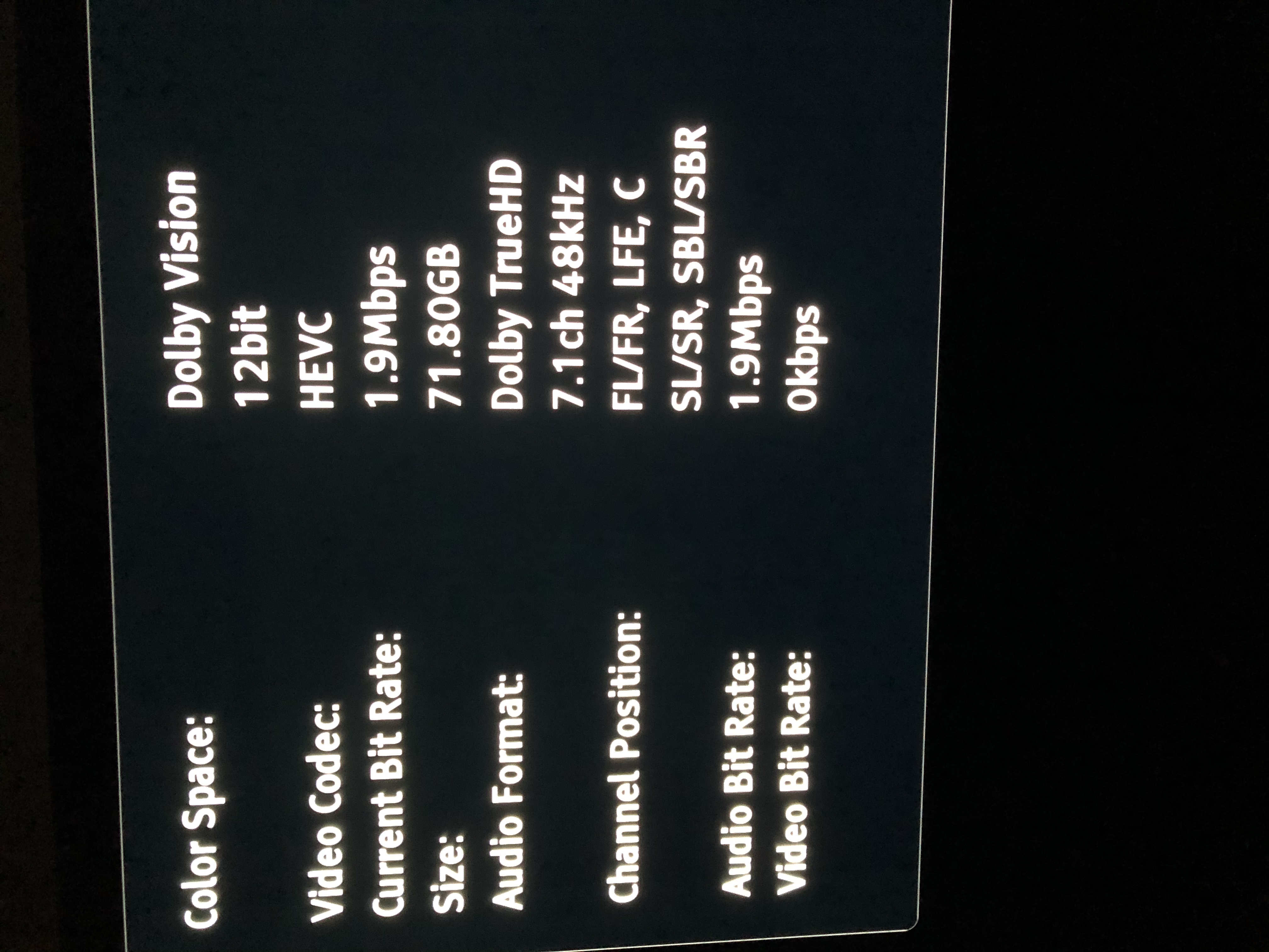

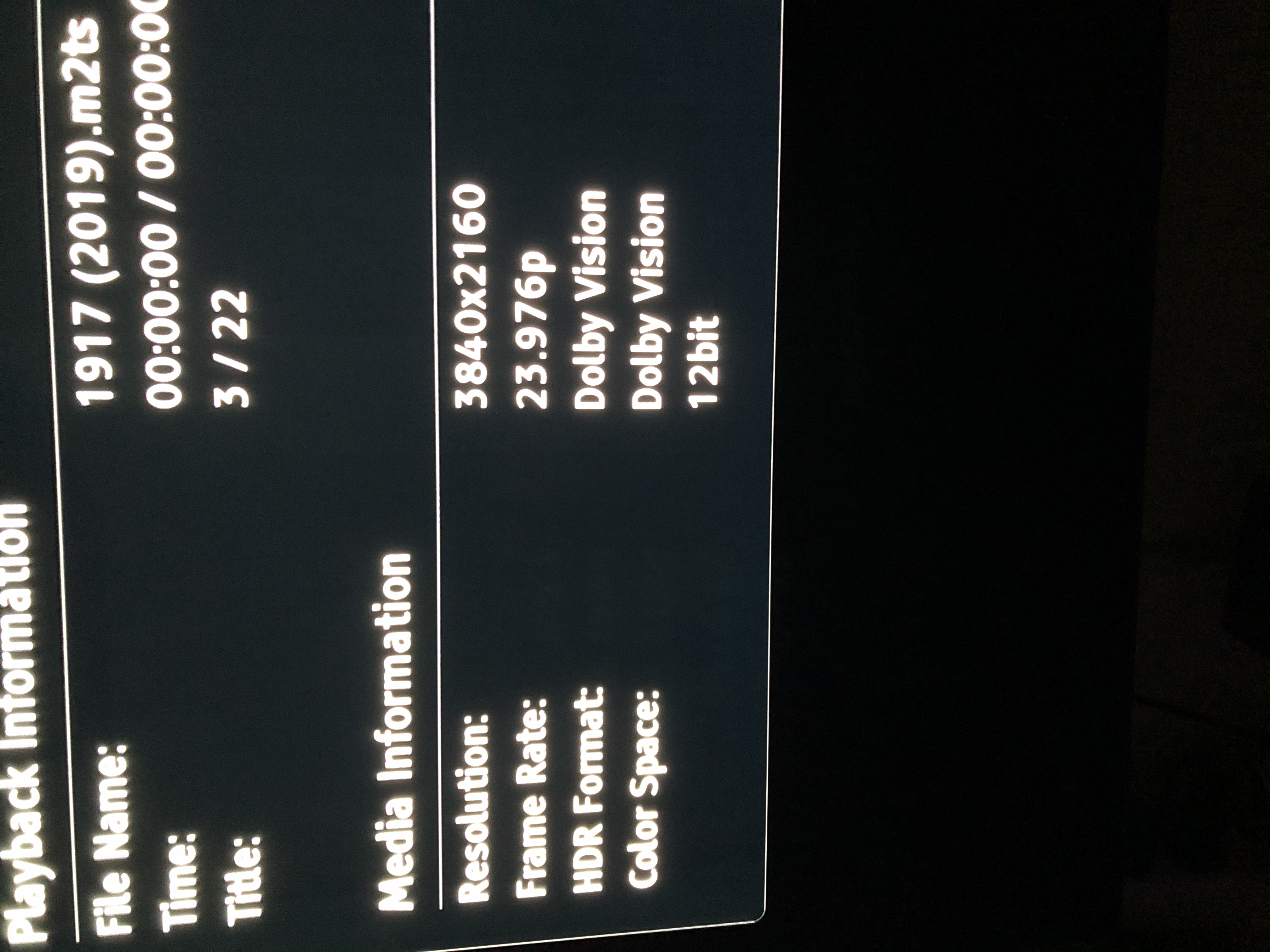

Here are the Mission Impossible Fallout pics
Hi, can confirm this mux of 1917 that didn’t work on the Oppo works in Dolby Vision and Atmos on 2019 shield pro, shame I will have to have 2 muxes of some FEL movies till it’s sorted, particularly because the Oppo is a better picture, the Colours are more balanced.
