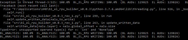

Post by shawnc22 » Tue Mar 17, 2020 7:22 pm
yusesope wrote: Tue Mar 17, 2020 6:27 pm
shawnc22 wrote: Tue Mar 17, 2020 5:04 pm Just tried the revised version and got an exception at the end when everything reached 100%
I forgot a line of code again :lol: .
I updated the link of my previous post (do not follow the link in the quote).
When you feel like it, try again.
haha that's what i figured, but unfortunately still stuck after everything reaches 100%:
been like this for about 30 mins now. looks like there might be an extra AUD in the EL?

yusesope
Posts: 221
Post by yusesope » Wed Mar 18, 2020 10:58 am
shawnc22 wrote: Tue Mar 17, 2020 7:22 pm ...but unfortunately still stuck after everything reaches 100%...
This time it's not my fault :lol: !
There seems to be a little bit missing in the BL Layer: my program is in eternal expectation of a data that will never arrive! What is the title of the movie?
