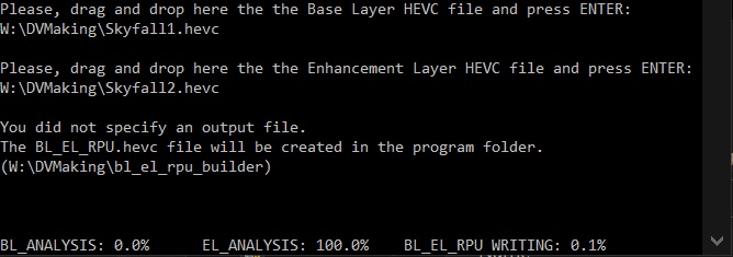

@yusesope
I'm still getting this with all the Bond movies I've tried, EL analysis shoots up to 100% right away, and BL stays at 0. Any idea what's going on here?

#1640 Post by Arbigator » Sat Mar 14, 2020 6:21 pm
That was Skyfall, happened on Spectre as well. Can you tell me the command you use to extract the video streams with eac3to?

Arbigator wrote: Sat Mar 14, 2020 6:16 pm I'm still getting this with all the Bond movies I've tried, EL analysis shoots up to 100% right away, and BL stays at 0. Any idea what's going on here?
The EL layer is empty. There are two possibilities: the original file is corrupt or you are wrong to demux the original file.
