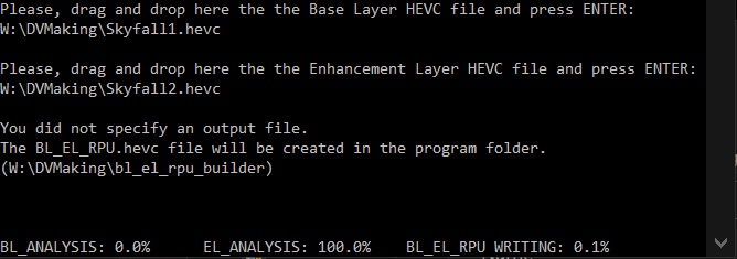

@yusesope
I'm still getting this with all the Bond movies I've tried, EL analysis shoots up to 100% right away, and BL stays at 0. Any idea what's going on here?

Arbigator
Posts: 32
Post by Arbigator » Sat Mar 14, 2020 6:21 pm
That was Skyfall, happened on Spectre as well. Can you tell me the command you use to extract the video streams with eac3to?
Angryunibrow
Posts: 104
Post by Angryunibrow » Sat Mar 14, 2020 6:34 pm
Arbigator wrote: Sat Mar 14, 2020 6:21 pm That was Skyfall, happened on Spectre as well. Can you tell me the command you use to extract the video streams with eac3to?
Latest version of eac3to (3.34)
eac3to \path\to\bluray\ (might need " " around the directory if you have spaces in the directory or file names)
Once you get the path, usually 1)
eac3to \path\to\bluray 1) 2:BL.hevc 3:EL.hevc
The 2 layers are usually 2 & 3 (1 is always chapters)
Angryunibrow
Posts: 104
Post by Angryunibrow » Sat Mar 14, 2020 8:22 pm
Skyfall worked just fine.
eac3to to demux
using temp version revision 2 of the tool. (bl_el_rpu_builder_temp_version_revision_2.py)

Arbigator wrote: Sat Mar 14, 2020 6:16 pm I'm still getting this with all the Bond movies I've tried, EL analysis shoots up to 100% right away, and BL stays at 0. Any idea what's going on here?
The EL layer is empty. There are two possibilities: the original file is corrupt or you are wrong to demux the original file.
Angryunibrow wrote: Sat Mar 14, 2020 8:22 pm
