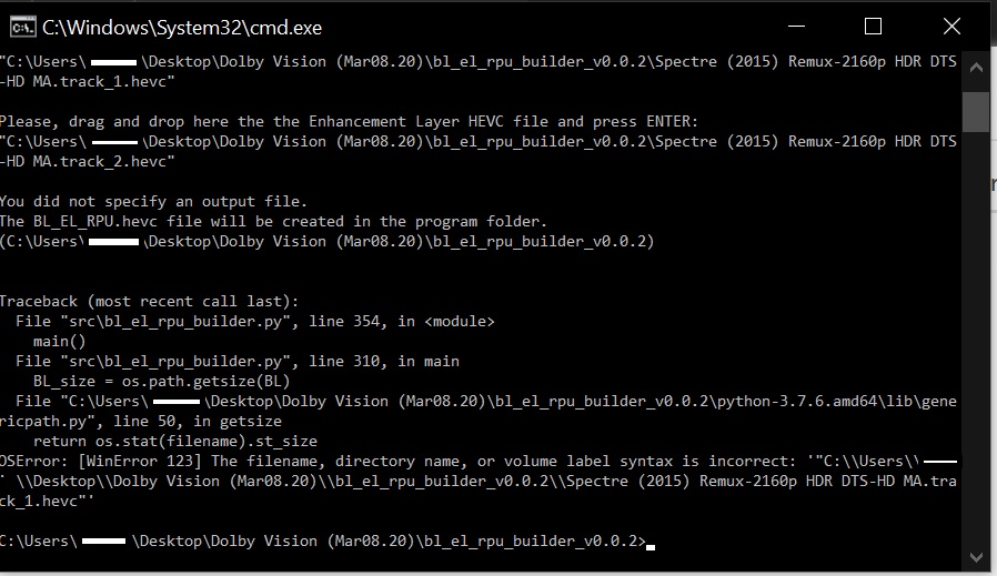

Arbigator
Posts: 32
Post by Arbigator » Mon Mar 09, 2020 5:43 pm
@yusesope
Thanks for guiding me. I did that and it's returning the following message "OSError: [WinError 123] The filename, directory name or syntax is incorrect"
It's putting 2 slashes in the directory where there should only be one.
eg. "c:\\path\\to\\the\\hevc\\files.hevc"
Seems like a strange problem, any idea how to fix that? Sorry, but I know nothing about this stuff otherwise I would try.
bl_el_rpu builder error.jpg (154.47 KiB) Viewed 30663 times
yusesope
Posts: 221
Post by yusesope » Mon Mar 09, 2020 8:06 pm
Arbigator wrote: Mon Mar 09, 2020 5:43 pm ..."OSError: [WinError 123] The filename, directory name or syntax is incorrect"....
the problem is represented by the spaces present in the file name and in the name of the folder hosting my program.
To work around the problem:
  • download Notepad ++ (HERE)
  • Unpack the archive
  • start notepad ++. exe
  • Open (in notepad ++) the "bl_el_rpu_builder.py" file inside the "src" folder of my program
  • Scroll down to lines 295 and 296 and edit them (bottom image) by adding to both the string:
    .replace("\"","")
  • Save your changes and close Notepad ++
  • Start my program normally.

However, after muxing to .ts I'm still only able to get playback in HDR on the 2019 Shield with Plex and on my B9, the dolby vision flag never popped up.
I had this issue earlier, and it was because my Plex app wasn't up to date on the Shield. Even though I had auto updates on, I had to go into the play store and manually search for the Plex app to update. The updated app includes the new exoplayer that should now support DV videos.
Arbigator
Posts: 32
Post by Arbigator » Mon Mar 09, 2020 10:25 pm
shawnc22 wrote: Mon Mar 09, 2020 10:08 pm
Arbigator wrote: Mon Mar 09, 2020 10:04 pm That worked, thank you!
There was an update, but unfortunately that didn't fix it... I'm going to try another movie and see what happens
