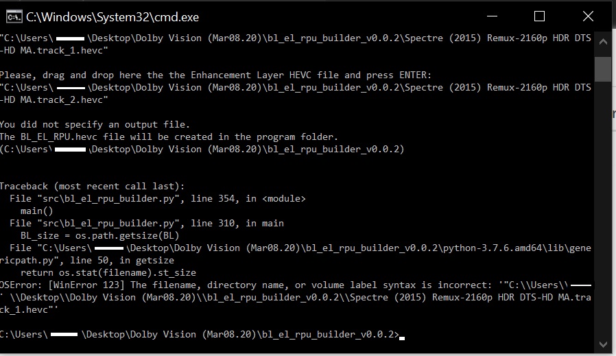

Arbigator
Posts: 32
Post by Arbigator »
@yusesope
Thanks for guiding me. I did that and it's returning the following message "OSError: [WinError 123] The filename, directory name or syntax is incorrect"
It's putting 2 slashes in the directory where there should only be one.
eg. "c:\\path\\to\\the\\hevc\\files.hevc"
Seems like a strange problem, any idea how to fix that? Sorry, but I know nothing about this stuff otherwise I would try.
bl_el_rpu builder error.jpg (154.47 KiB) Viewed 30583 times
yusesope
Posts: 221
Post by yusesope »
Arbigator wrote: Mon Mar 09, 2020 5:43 pm ..."OSError: [WinError 123] The filename, directory name or syntax is incorrect"....
the problem is represented by the spaces present in the file name and in the name of the folder hosting my program.
To work around the problem:
  • download Notepad ++ (HERE)
  • Unpack the archive
  • start notepad ++. exe
  • Open (in notepad ++) the "bl_el_rpu_builder.py" file inside the "src" folder of my program
  • Scroll down to lines 295 and 296 and edit them (bottom image) by adding to both the string:
    .replace("\"","")
  • Save your changes and close Notepad ++
  • Start my program normally.

Arbigator
Posts: 32
Post by Arbigator »
That worked, thank you!
