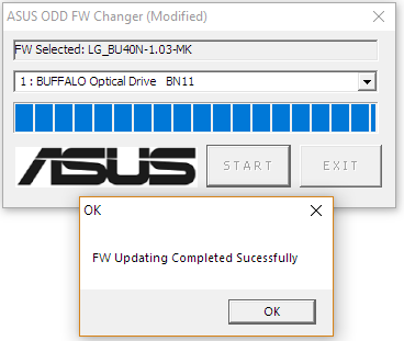

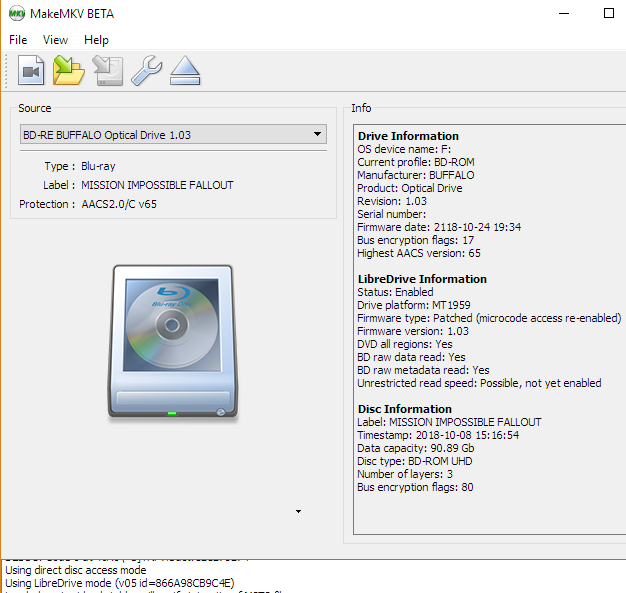

just wanted to report back that my Buffalo BRXL-PT6U2VB is a UHD-friendly device now:
1. Crossflashing worked like a charm with this MK firmware
2. Device shows up as LibreDrive compatible:
3. and CAN FINALLY READ UHD-blurays:
@mike admin
Just in case you might be still interested in Buffalo firmwares, they released a new FW update tool [brdrive_fwupdater_200.exe], featuring:
a. Buffalo_BU40N_FW_Updater_2.01.exe
b. Buffalo_BH16NS58_FW_Updater_2.01.exe
