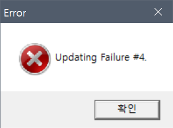

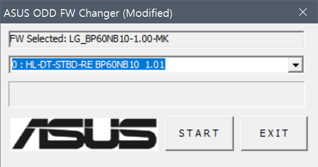

Hello.
Downgrading firmware to version 1.00 using ASUS flashing tool failed.
What should I do ?
ASUS_ODD_FW_Changer_(Modified) (24.08.2019)
HL-DT-ST-BD-RE_BP60NB10-1.00-NM00200-211711211720
What should I do ?
- 2020-01-23 13;22;38.png (15.95 KiB) Viewed 32460 times
- 2020-01-23 13;22;35.png (35.5 KiB) Viewed 32460 times

Is that drive in an external enclosure? Then that might be the reason. Some enclosures don't support all necessary commands via USB.

Re: BP60NB10 Firmware Downgrade Error
Please try and contact Mike (mike admin) and see if he can extract 1.01 from your drive. If he is able to extract it, he will be able to make a MK firmware.root7053 wrote: Thu Jan 23, 2020 4:34 am Hello.
I Use USB external ODDCoopervid wrote: Thu Jan 23, 2020 6:44 pm Is that drive in an external enclosure? Then that might be the reason. Some enclosures don't support all necessary commands via USB.
I guess your enclosure doesn't support the necessary command via USB. If you can take it out and attach it directly to the SATA port of yor PC it will most likely work to flash it.
After that you can put it back into the enclosure and you are all set.
Be sure to have the newest modified ASUS flasher.
Those with 1.01 cannot currently be downgraded. Please contact mike admin and see if he can extract a copy of the firmware from your drive.peter-a wrote: Sun Jan 26, 2020 10:27 pmThe software file I downloaded was "ASUS_ODD_FW_Changer_(Modified) (24.08.2019).zip"
