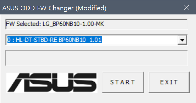

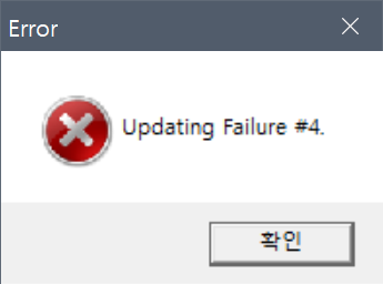

Hello.
Downgrading firmware to version 1.00 using ASUS flashing tool failed.
What should I do ?
ASUS_ODD_FW_Changer_(Modified) (24.08.2019)
HL-DT-ST-BD-RE_BP60NB10-1.00-NM00200-211711211720
What should I do ?

- Posts: 4734
Re: BP60NB10 Firmware Downgrade Error
Is that drive in an external enclosure? Then that might be the reason. Some enclosures don't support all necessary commands via USB.
I Use USB external ODDCoopervid wrote: Thu Jan 23, 2020 6:44 pm Is that drive in an external enclosure? Then that might be the reason. Some enclosures don't support all necessary commands via USB.
- Posts: 4734
I guess your enclosure doesn't support the necessary command via USB. If you can take it out and attach it directly to the SATA port of yor PC it will most likely work to flash it.
After that you can put it back into the enclosure and you are all set.
