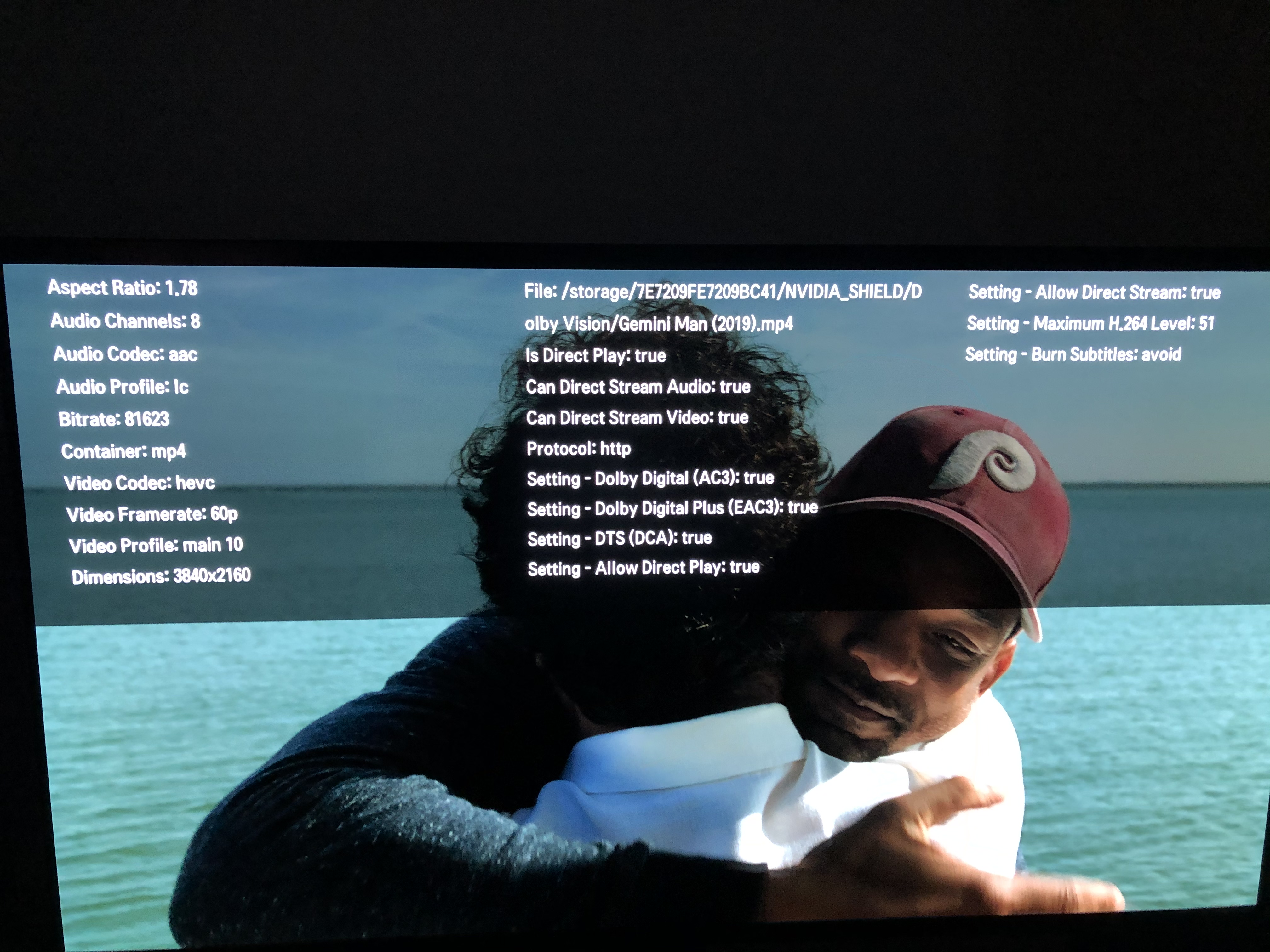

DaMacFunkin
Posts: 314
Post by DaMacFunkin »
deadchip12 wrote: Sat Jan 25, 2020 2:58 am Man I tried many ways but still couldn't make Gemini Man in dolby vision to run at the correct 60 fps. I suspect there is mismatch between the framerate of 2 video layers somehow since the hdr10 version runs perfectly fine at 60fps.
Hi, I have 2 set ups LG C9 and LG C7, none have problems playing back single layer Gemini man at 60fps via the internal Plex app over wired gigabit network, I have all motion processing disabled on both sets.
On my C7 I have a normal shield (2017) as Plex server and my DV files plugged into that via USB 3, I can then play them back via the built in Plex app.
On my C9 I have a new DV shield and my DV files plugged into that via a usb 3 drive, that the goes through a Denon 5.2.2 system, I can then playback via Plex on the shield or Plex on the C9 with no problems.
On my DVDfab single layer of Gemini Man I even made a 7.1 aac at quality 1.0 with neroaac codec and muxed that back in.

DaMacFunkin wrote: Sat Jan 25, 2020 7:23 am
On my DVDfab single layer of Gemini Man I even made a 7.1 aac at quality 1.0 with neroaac codec and muxed that back in.436CABEC-0FD9-4933-847B-CEF2D33D8096.jpeg
Is there a way to make it work for double layer? I don’t really want to try making a single layer because some people say it is questionable whether the dolby vision of that is real or simply hdr10 with false dolby flag.
