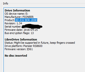

That's what I get on my Pioneer BDR 209D. You mean there's a chance?mike admin wrote: Tue Dec 03, 2019 10:54 pmDo you get a "keep fingers crossed" status on the right pane? If yes, you might get a working drive in a foreseeable future...pmhCH wrote: Tue Dec 03, 2019 8:49 am I already sent in a dump of the firmware. So if you need a drive working now with UHDs, better go with the Asus.

I just realized: I can't seem to find any info that my BDR-209D(BK) supports BD-XL? Isn't BDXL compatibility required for even the slightest chance of my drive becoming UHD Friendly in the future?
- drive info.PNG (8.89 KiB) Viewed 76171 times

No answer to this?nicolaidenmark wrote: Fri Dec 13, 2019 7:26 am I just realized: I can't seem to find any info that my BDR-209D(BK) supports BD-XL? Isn't BDXL compatibility required for even the slightest chance of my drive becoming UHD Friendly in the future?

exactly what the libredrive info section shows maybe in the future

So, my drive is BDXL compatibile?

"I can't seem to find any info that my BDR-209D(BK) supports BD-XL?"
Can't find info? A quick and simple Google search returns several sources on this. Example:
https://goughlui.com/2014/08/02/review- ... ay-writer/
https://www.google.com/search?client=fi ... JEQ4dUDCAo
In short, no BDXL support on that drive. Libredrive is NOT a magic pill or a "fix for all my problems" solution for UHD backup/ripping. Buy a proper UHD compatible drive from the guide to ensure compatibility now and in the future. Not all drives may be compatible for this and some never will be.

BDXL support does not necessarily mean UHD is possible. There are two "flavors" of BDXL, and UHD uses the higher-density one that became available in late 2015.
There are a lot of old-version BDXL drives out there... I own some.
