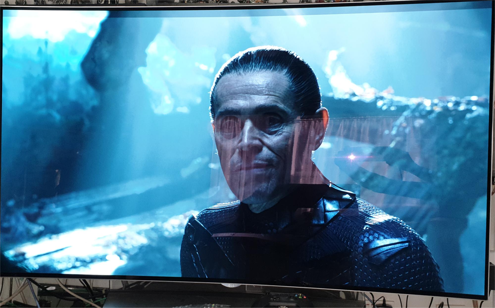

The only file I have had a problem with is Gladiator, for some reason there are errors at the beginning of the mux, I have ripped it many times and still the same, if I can get past the studio logo it plays fine.
