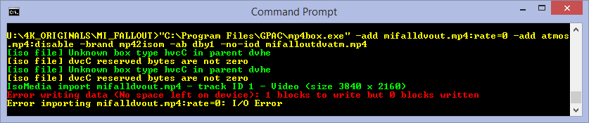

I did some software experimentation...
Using MI Fallout (DV + Atmos), I looked at the following:
1) Demuxing with EAC3TO - although it listed the EL as track 3, when all was demuxed, the EL layer was left behind. I could manually demux this layer later.
2) Demuxing with TSMuxer:
a) Using the Stream to demux, both the BL and EL were checked off to be demuxed.
b) Using the Playlist to demux (same length), only the BL was checked off to be demuxed.
3) Demuxing with FFMpeg - using the method in this thread, the EL and BL HEVC files were identical to the h265 files created by EAC3TO.
4) The Dolby VES muxing operation described in this thread worked flawlessly on both the BL/EL HEVC and the EAC3TO h265 files.
5) The final MP4 muxing operation (GPAC 0.80) was unsuccessful
despite having 1TB of space available on the U: drive.

- Posts: 2421
if you dont add -tmp U:\ then C:\ is used for the temp fileskws53 wrote: Fri Nov 08, 2019 8:55 pm
5) The final MP4 muxing operation (GPAC 0.80) was unsuccessfuldespite having 1TB of space available on the U: drive.

- Posts: 49
- Joined: Sun May 04, 2014 9:09 pm
Wasn't aware temp files were created, thank you for the explanation. Since the combined size of the files is ~85GB, I can see the issue...RESET_9999 wrote: Fri Nov 08, 2019 10:04 pmif you dont add -tmp U:\ then C:\ is used for the temp fileskws53 wrote: Fri Nov 08, 2019 8:55 pm
What exactly is the reason for a temp file anyway? We're simply muxing, aren't we?
