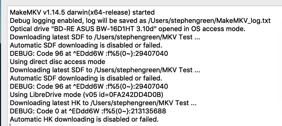

For the last week or two, every time I launch MakeMKV or insert a new BD disc, it hangs on downloading "latest SDF," and then says "automatic SDF downloading is disabled or failed." From there however, it would read and decrepit ordinary BD discs just fine.
I've just purchased a modified UHD drive from one of our fellow board members (highly recommended!) and when I try to decrypt a UHD disc, SDF and HK downloading fails, MakeMKV suffers a fatal error and crashes. It still works just fine (other than the download failure) on BD discs.
I've looked at MakeMKV's settings, and "allow contacting web server for updates" is checked. MakeMKV.com is whitelisted in Pi-Hole, and the app has permission to accept connections in macOS's built-in firewall.
What am I doing wrong, and how do I fix it?

Never mind -- problem solved!
I poked into my network, and discovered I'd added a few dodgy-looking countries to UniFi's GeoIP blocking feature. Apparently, MakeMKV is hosted in one of those dodgy-looking countries.
If you're having a similar issue and you use UniFi networking gear, try turning off the GeoIP filter.

No, the problem is on the MakeMKV server end - the domain that was being used has (probably) expired, so you cannot reach it anymore. Only Mike can fix that.
In the mean time, the manual download is the only working method (link earlier in the topic).
