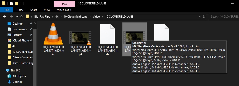

Well, MP4 as a container doesn't support HD audio formats such as TrueHD, DTS-HD MA, Atmos, and DTS:X so there's another problem. Go look at your MP4 output from DVDFab and you'll see you have AC3 or DTS. In the thread you've not read through yet they've been working on hacking HD audio formats into the MP4 container, but, that still doesn't help you. You really do need to start reading because I'm not going to reiterate everything that's been said in this thread about all the issues involved with Dolby Vision. You need to research because the answers are out there and it's a very complicated topic.

p.s. I checked out the mp4 and the audio was as you said in AAC and the Dolby Vision in another 1080P video within it.
