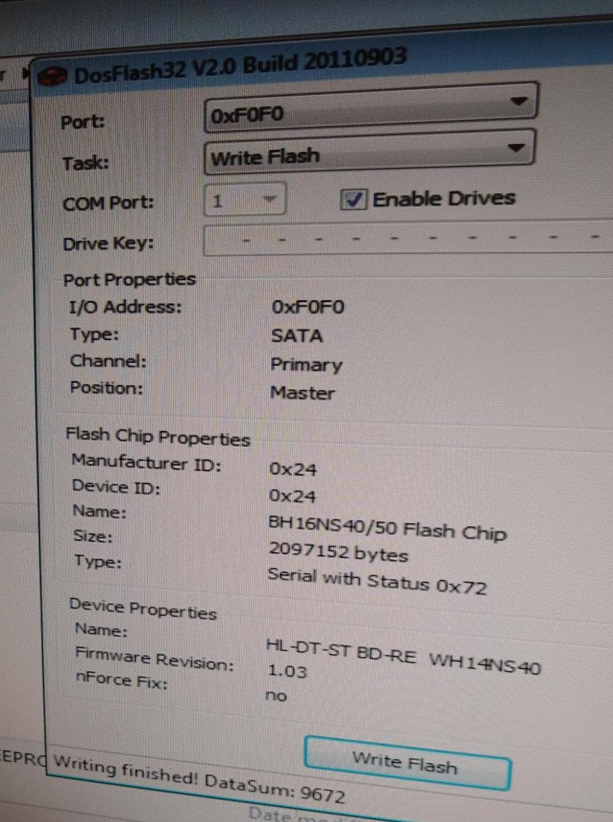

#19 Post by gefukt » Tue Mar 12, 2019 12:14 am
drive saved-flash success.jpg (177.18 KiB) Viewed 38628 times
I found the Julia Window PE and booted to that and it worked!!!
The drive is saved thanks to you guys!!
If you have one of these drives that you think you bricked, you should be able to bring it back to life and I'd be happy to help anyone who did this and I'll do what I can to save you going through my mistakes.
Thank you so much. The drive, a first gen WH14NS40 is not UHD-friendly and does not support LibreDrive mode, but at least it is now a working Blu-ray burning drive again.
Thank you, Thank you, Thank you!!!!!!!!!!!!!

I've tried following these steps as best as I can understand them, but I'm getting stuck...
As with the OP, I flashed NS50 to my NS40 drive and now it can't read discs. I was able to boot into a 32bit Windows and get DOSFlash to see the drive, but I have no binary to flash to it. I downloaded what was supposed to be the stock firmware, but it's an EXE, not a BIN. No one seems to have the actual firmware file that I can just flash to the drive. Is there some way to get the BIN file out of that EXE, or some site that I can download it from?
The drive is WH14NS40 on 1.03.

#24 Post by MartyMcNuts » Mon Jul 22, 2019 1:15 am
Ceetch wrote: Sun Jul 21, 2019 11:54 pm I've tried following these steps as best as I can understand them, but I'm getting stuck...
You have to extract your firmware with dosflash first.
Posts: 1716
Re: Help an idiot with a 1st gen WH14NS40
#25 Post by d00zah » Mon Jul 22, 2019 1:18 am
And apply calibration data (DataMover) to this:
WH14NS40_1.02-A0.zip
Ceetch
Joined: Sun Jul 21, 2019 11:50 pm
#26 Post by Ceetch » Mon Jul 22, 2019 1:55 am
I finally managed to get DOSFlash to work and get my old firmware out. I also got the firmware extractor tool that got the BIN out of the EXE and copied the calibrations to it and I was able to flash it back to my drive and resurrect it. Unfortunately, I had to do this using that buggy Julia ISO of Windows 7, so it took a couple tries to flash it. For some reason that ISO kept resetting everything, the mouse and keyboard kept disappearing, drives went offline....it's a mess. At the same time, I was able to get the drive working again, so there's that... Now we just need a proper NS40 patched firmware with that LibreDrive patch and I'll be set.
