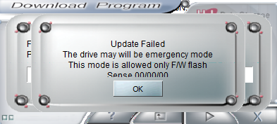

Just bought an LG BH16NS55 with firmware 1.04
Was getting nowhere on my win10 machine (probably because it only has AHCI)
I've hooked it up to a Win7 machine with AHCI disabled in bios, attempted to flash to asus 3.10 bios with both the asus odd and lg crossflash utilities and still no go.
asus odd gives me Update Failure #4 errors and the lg crossflash gives me errors.
I'm sure there's something simple I'm overlooking, anyone have any insight?

Re: LG BH16NS55 Firmware 1.04 (and possibly other new drives)
Also I'll just note those are the errors appearing on the Win7 machine, win10 gives me different errors (see attached)
Again connected on sata straight to the board
- fek2.PNG (2.35 KiB) Viewed 38030 times
- fek.PNG (89.24 KiB) Viewed 38030 times
- Posts: 6012
A program on your pc is probably taking exclusive control of your optical drives not allowing them to be flashed I have seen this a few times when remote flashing for people. Close all programs that have anything to do with optical driveskillkong1211 wrote: Tue Jul 16, 2019 7:58 am Also I'll just note those are the errors appearing on the Win7 machine, win10 gives me different errors (see attached)

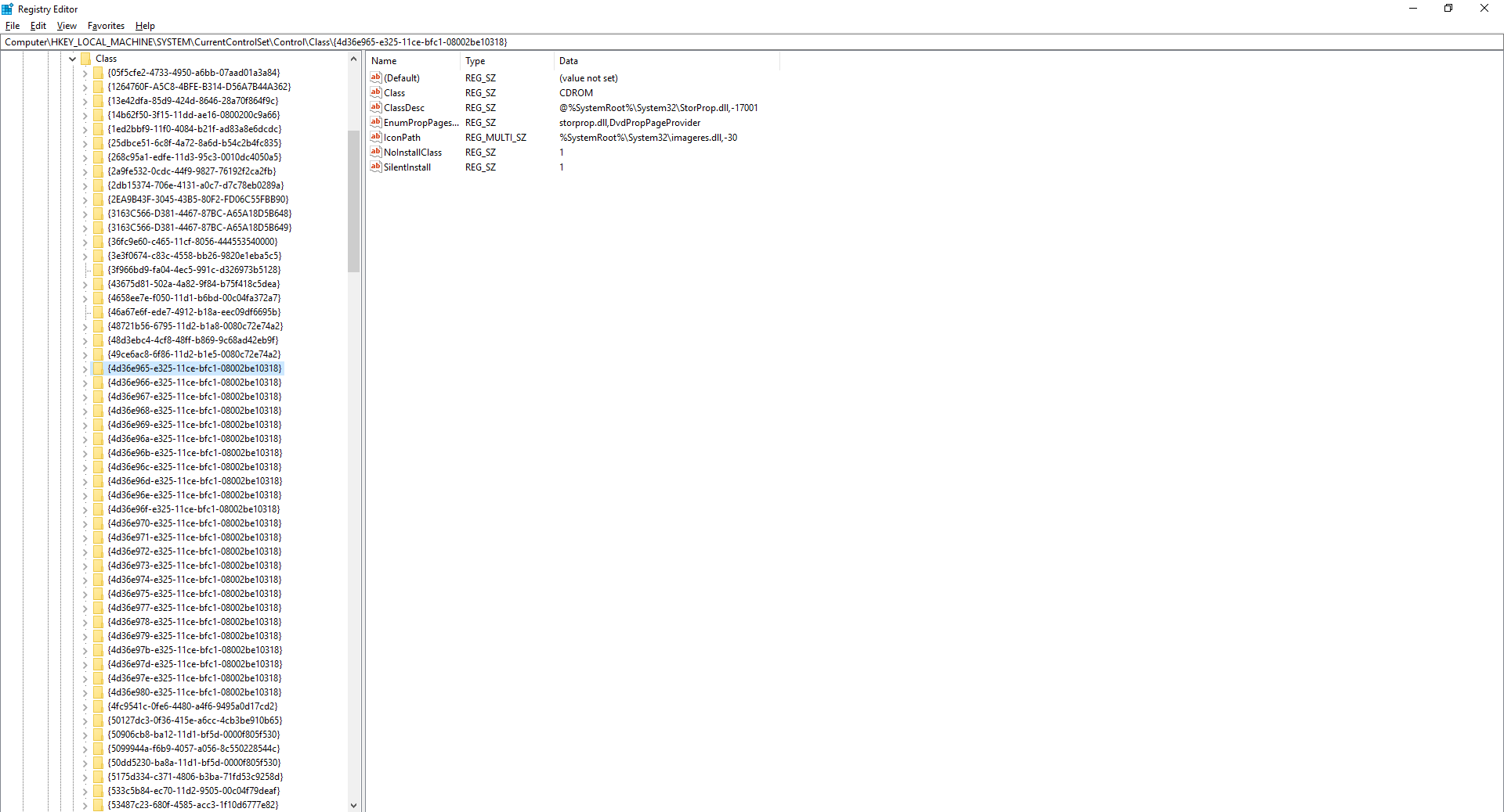

Drivers I can redownload, but what do you mean by filters?
https://www.techsupportall.com/fixed-so ... er-filter/
It doesn't just apply to optical drives that can't be found. Messed up filters can cause other issues, as well.

killkong1211
- Posts: 21
- Joined: Mon Jul 15, 2019 11:00 am
No luck on filters, didn't have an upper or lower filter in that registry key.SamuriHL wrote: Tue Jul 16, 2019 10:48 pm https://www.techsupportall.com/fixed-so ... er-filter/
On the win10 or win7.

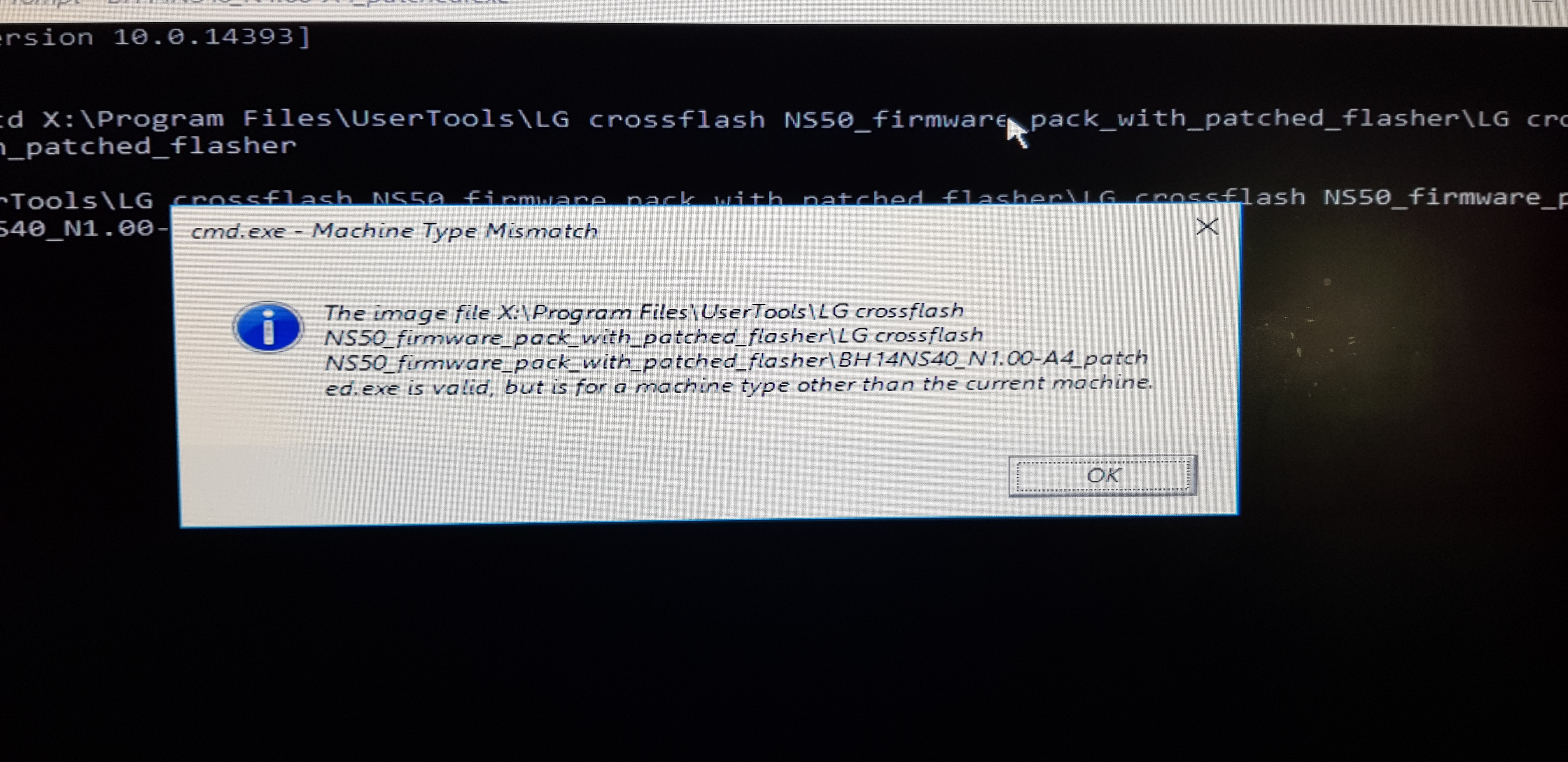

killkong1211
- Posts: 21
I'm in PE now but the lg flasher won't launch, it should just launch if I try to run it yeah? No extra steps needed?Billycar11 wrote: Wed Jul 17, 2019 7:54 am
try making a bootable pe windows on a flashdrive https://www.aomeitech.com/pe-builder.html i have flashed 100+ drive in that it should work
the asus flasher wont work on that one no .net but that eliminates the software variables completely.
then you just try asus 3.10mk with the lg flasher and see if it works if not your probably just better buying a preflashed one
because then your sata controller or something is not passing the commands
Edit: tried to launch from cmd and got the attached
