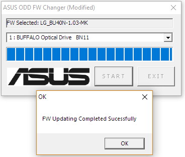

1. Crossflashing worked like a charm with this MK firmware

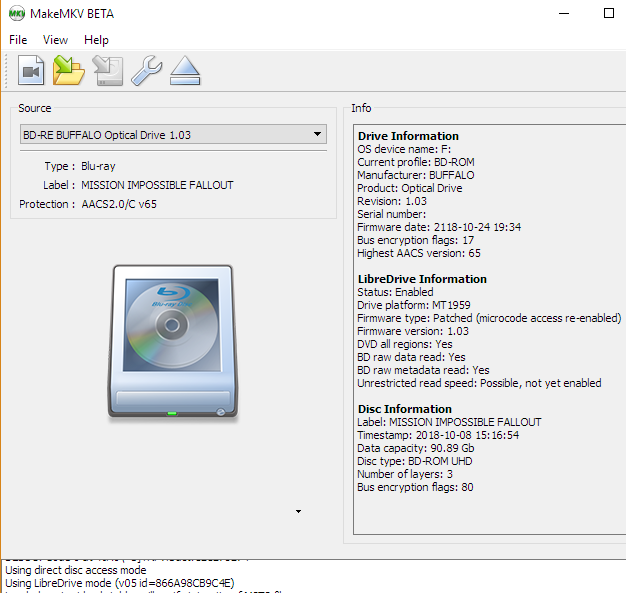

2. Device shows up as LibreDrive compatible:

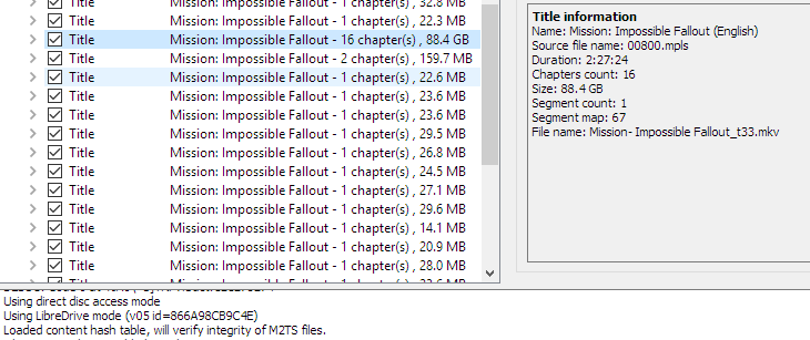

3. and CAN FINALLY READ UHD-blurays:
