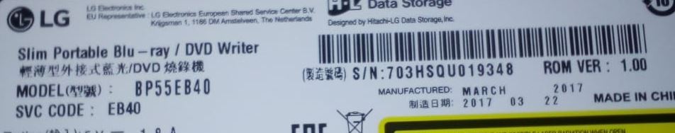

First of apologises for posting in wrong section earlier and double posting. I tried to delete but realized I posted in wrong section. I have drive Slim Portable LG-BP55EB40 SVC Code EB40
Firmware Ver 1.00 is this drive upgrade to UHD friendly LibreDrive
Can anyone tell me if I use new flasher will it damage this drive. Under the MK directory there is firmware for BP55EB40-NB50?
