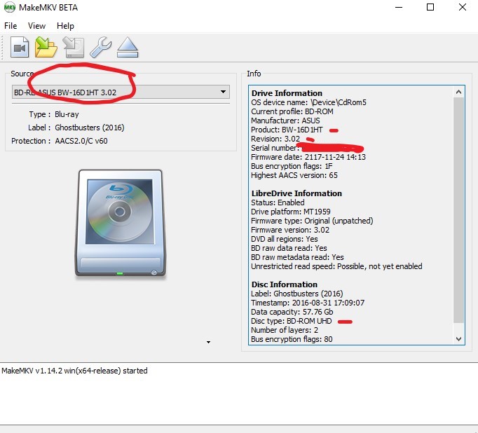

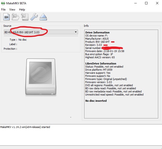

I have patched the official ASUS BW-16D1HT 3.02 Firmware Updater using Mike's instruction and used this to downgrade a BW-16D1HT-PRO with 3.03 to a BW-16D1HT with 3.02 by using just this exe.
The drive was connected via USB and firmware update (downgrade!) worked flawlessly!!!!
Here is the before & after:
