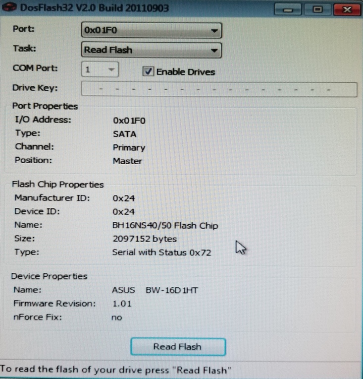

Joined: Thu Jan 03, 2019 5:46 am
Re: 100% Firmware Downgrade for ASUS BW-16D1HT and LG BH16NS55
Post by badtzhk88 » Mon Jan 07, 2019 3:42 am
Mine is ASUS BW-16D1HT
Firmware 1.0.1
BH16NS60/50 Flash Chip
I have dump the flash
Anything I should do ?
Upgrade to 3.0.1 ?
Thanks for any comment
asusfalsh101.zip
(1.16 MiB) Downloaded 1440 times
Posts: 6013
Post by Billycar11 » Mon Jan 07, 2019 4:07 am
badtzhk88 wrote: Mon Jan 07, 2019 3:42 am Mine is ASUS BW-16D1HT
Firmware 1.0.1
Upgrade to 3.0.1 ?
to old if it came with 1.xx firmware needs 3.00+ and 2015+ build date
st4evr
Posts: 705
Post by st4evr » Mon Jan 07, 2019 4:15 am
Firmware 1.0.1
Upgrade to 3.0.1 ?
Simple. Buy a new UHD Friendly drive. That drive is too old. Asus 1.0 firmware drives predate UHD compatability by several years. If you attempt an update to newer 3.0+ firmware you’ll brick the drive and simply end up with a nice paperweight or doorstop.
