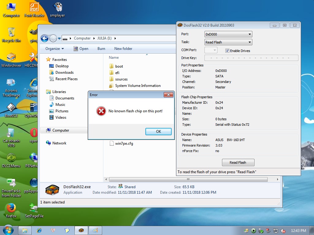

I was more successful with the Windows environment, but it remains weird. With the normal dosflash32.exe, I received the same error as in DOS. I took a screenshot so that you can see what I mean. I then used the dosflash32_BH16NS40.exe, which was also created with the Windows bootable and it worked instantly. So I have my dumped firmware.
I then used the Data Mover with a clean 3.00 firmware, but my drive still rejects it when I try to flash the new firmware, still saying the DRAM write error. I attached the dumped firmware as txt-file, so maybe if someone would be so kind to convert it for me, that would be great. Just in case I made a mistake. My drive is the Asus BW-16D1HT. Any help would be appreciated.

You're on the wrong port dude, make sure it's 0X01F0 and channel reads "Primary"

Also are you using SATA 0 for the drive with nothing else plugged into any SATA port?

@Colindo,
Here is an ASUS 3.02 created for you using your dump file data. As others have said, make sure you are on port SATA 0.

so to get this right, I definitely need to be on SATA0 to read out the flash drive, even if I managed to get one using SATA1? Do I also need to be on the right port to flash it? Does it need to be an IDE connection only for the read-out, or also for the flash?

I'm not Marty but I've flashed 7 drives in the last hour and a half. The answer is yes, SATA 0 with your SATA controller set to IDE mode.

you dont need to be on sata 0 or 1 mostly depends on motherboard im on port 3 and have flashed 50+ drives and never one writer error you do need IDE mode for dosflash if you were able to read the flash chip you are able to write it. think your main problem is that trash meme of a windows 7 pe image it has to many auto start auto driver config scripts and sometimes hides drives half way through you doing stuff i use win 10 pe but you can use any just make sure its 32 bit and in a mostly stock.Colindo wrote: Sun Nov 18, 2018 4:51 pm Thanks Marty,
