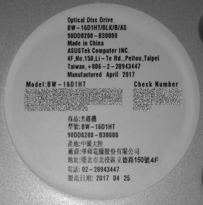

#40 Post by davidahn » Sat Apr 07, 2018 1:44 am
Report:
1. Asus BW-16D1HT purchased last week from Amazon
came with FW 3.00
Rips UHD perfectly, albeit slowly (about 3-4x). No failures yet on about 20 discs.
2. LG WH16NS40 svc code NS50 purchased this week from Amazon
came with FW 1.03
does NOT recognize UHD discs
Questions:
1. I am planning on downgrading the LG to 1.02; or should I cross flash to Asus 3.02?
2. Would I get any better read performance if I update the Asus to FW 3.02?
Thanks in advance.
