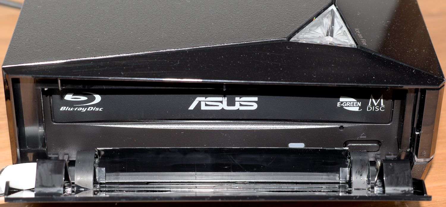

Just a update. Good news. I received the Asus BW-16D1X-U today and first thing I checked was the build date and serial number and It has a Pioneer BDR-212T. The serial of T4D and built date April 2025. Also I opened the front sliding door and saw the Pioneer branding they have on their drives plates. I was a little worried. Now time to get it ripping UHD after cross flash.

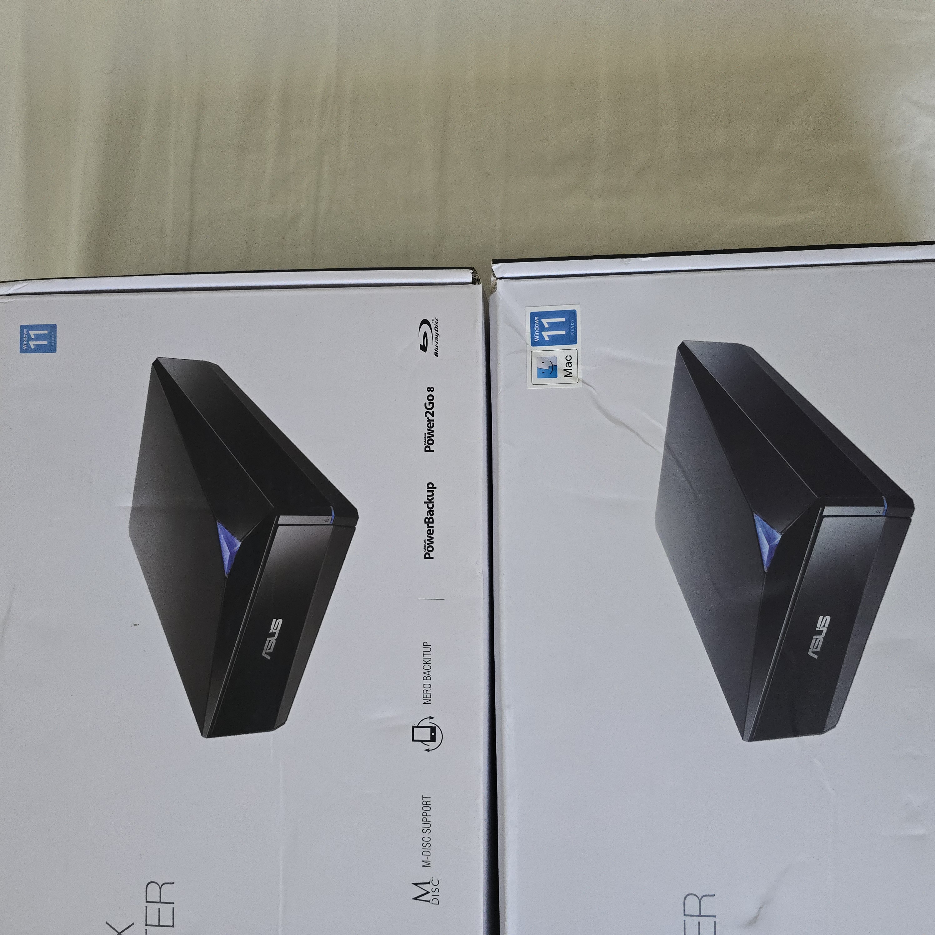

This is a observation. I noticed while looking at both ASUS BW‑16D1X‑U boxes one with LG BH50N / LG BH16NS40 the box color is white with slight purple tint - only has the windows 11 logo on the front. While the one with Pioneer 212t the box color is white - Mac OS and Windows 11 logo on front and side where the serial number is has a sticker made it Taiwan. Both have the same built year.

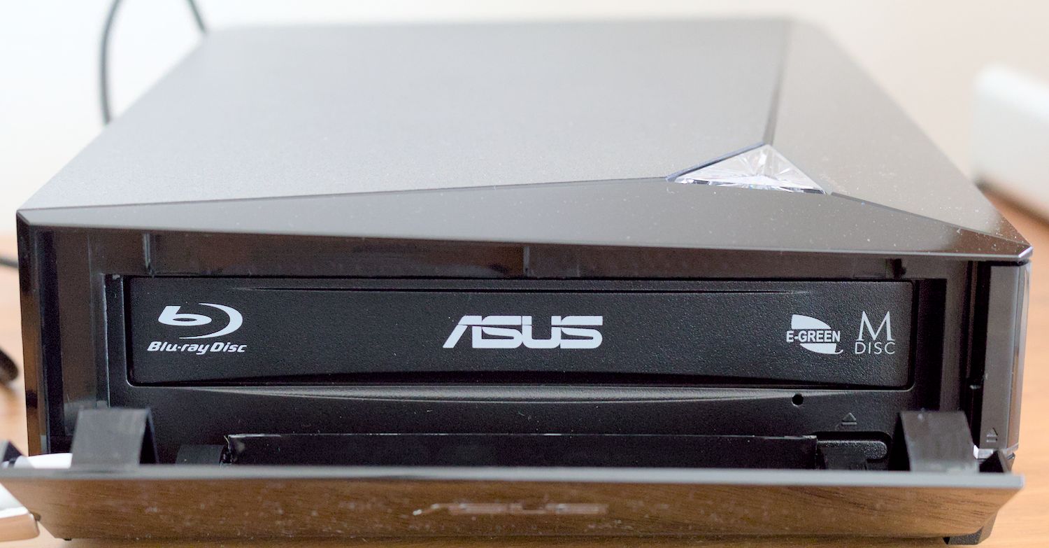

I just bought a new (not used) Asus BW-16D1X-U. Its serial number starts with TCD. The sticker on the bottom of the device tells me that it was manufactured in December 2025. Now I would like to find out what internal drive is installed in this external drive that was sold to me as an Asus BW-16D1X-U. But how do I do that? MakeMKV shows me the following information:

Why is the serial number shown by MakeMKV (starting with KLZ) completely different from the one that is printed on the stickers on the device and on the packaging? Does MakeMKV show the serial number of the actual internal drive? When the drive opens its disk tray, I can see the front of the internal drive. It looks very much like an Asus BW-16D1HT to me. But how can I be sure? Do I have to take the internal drive out of the enclosure to look at the sticker on the internal drive? If so, how do I go about doing that? Are there screws hidden underneath the rubber feet? Will such an operation void my warranty? And can someone already tell from the information I shared whether this drive can be flashed to be able to rip UHD Blu-ray disks?

Can this really be a drive from LG? The front looks exactly like an Asus BW-16D1HT. Does Asus sometimes slap the faceplate of an Asus BW-16D1HT onto drives from other manufacturers and sell them as Asus drives?

asus does not make the bw16d1htRalf Scheibler wrote: Sat Apr 11, 2026 1:23 pm Can this really be a drive from LG? The front looks exactly like an Asus BW-16D1HT. Does Asus sometimes slap the faceplate of an Asus BW-16D1HT onto drives from other manufacturers and sell them as Asus drives?
lg does
all asus does is rebrand drives

As mentioned, ASUS do not make drives. They are OEM, mostly from LG and Pioneer. The BW-16D1HT is a rebadged LG WH16NS40.Ralf Scheibler wrote: Sat Apr 11, 2026 1:23 pm Can this really be a drive from LG? The front looks exactly like an Asus BW-16D1HT. Does Asus sometimes slap the faceplate of an Asus BW-16D1HT onto drives from other manufacturers and sell them as Asus drives?
