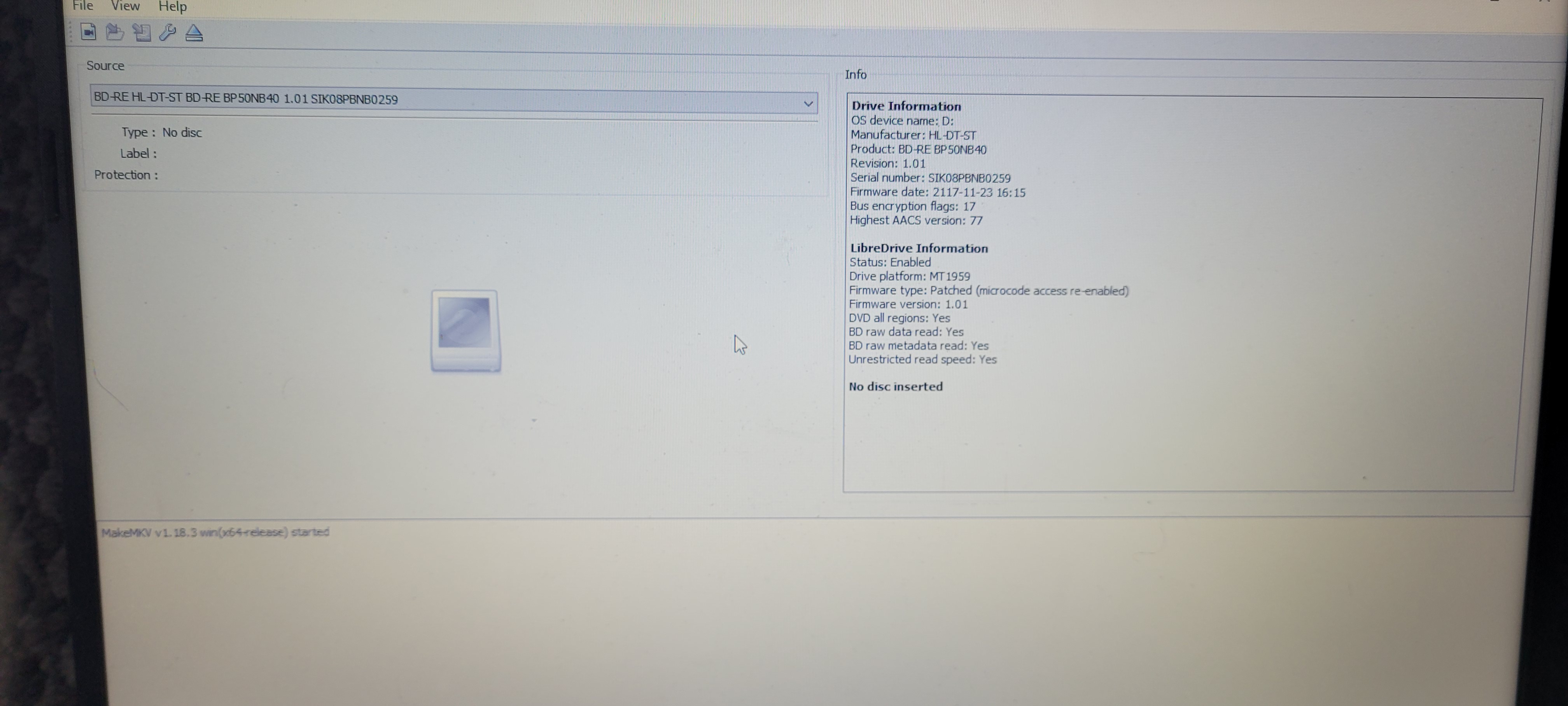

Re: SDFtool Flasher
So I followed the steps to flash my BP50NB40 drive. Make MKV says Liberdrive is enabled but the drive still won't read 4K discs. Any idea what's wrong?
- 20260422_100922.jpg (1 MiB) Viewed 9354 times
Re: SDFtool Flasher
Looks like you've only done the 1st part. See the "to flash the BP50NB40 SVC:NB52" notes in the 1st post of this topic.MrMegadeth99 wrote: Wed Apr 22, 2026 2:13 pm So I followed the steps to flash my BP50NB40 drive. Make MKV says Liberdrive is enabled but the drive still won't read 4K discs. Any idea what's wrong?

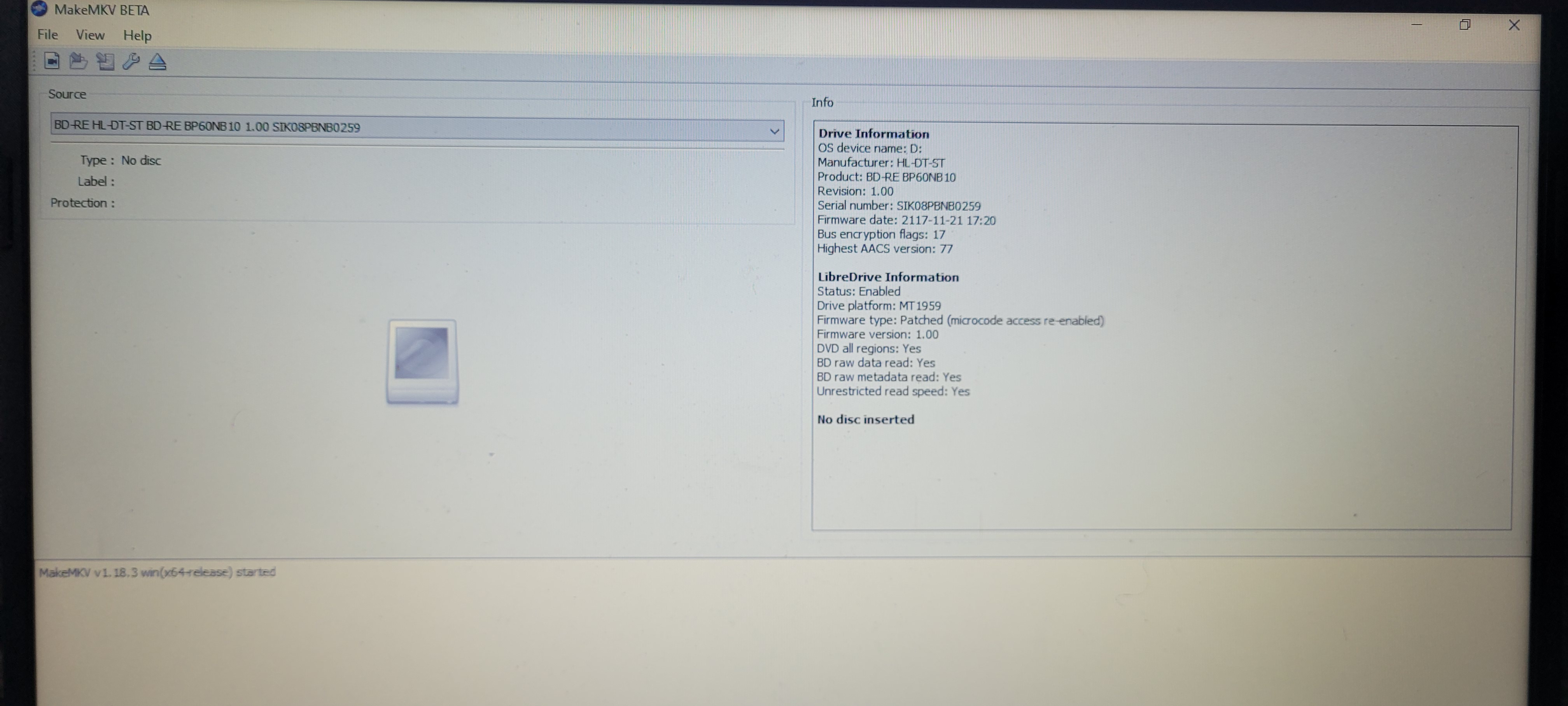

MrMegadeth99
- Posts: 24
- Joined: Sat Jun 08, 2024 3:01 am
Re: SDFtool Flasher
Ok I definitely did both parts now it looks like this but same issue, not reading 4K discs. Can anyone please assist?
- Posts: 6143
Re: SDFtool Flasher
whats the svc code on the drive if its not nb50 or 52 you bricked itMrMegadeth99 wrote: Wed Apr 22, 2026 2:13 pm So I followed the steps to flash my BP50NB40 drive. Make MKV says Liberdrive is enabled but the drive still won't read 4K discs. Any idea what's wrong?
MrMegadeth99
- Posts: 24
Re: SDFtool Flasher
Its NB52. Its not bricked it can still read blu rays.
- 20260422_102929.jpg (964.33 KiB) Viewed 9335 times
- Posts: 6143
Re: SDFtool Flasher
That image differs from the other one you posted it showed as bp60 there
Now it's back to bp50
Go back to bp60 fw
