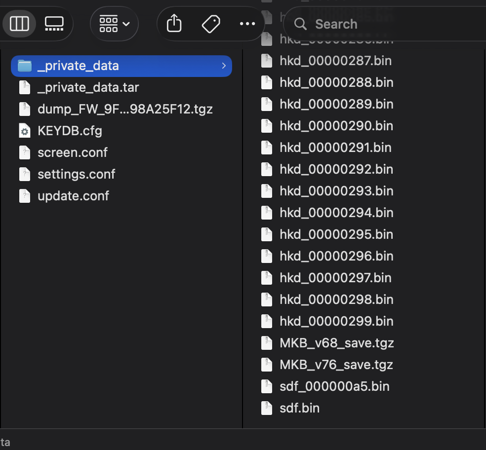

Re: Pioneer BDR-S13UBK Stopped Working
I am not seeing a keybd.cfg file in the _private_data.tar file. I *am* seeing many hkd_[xxx].bin files in the .tar file.
Billycar11 wrote: Wed May 20, 2026 11:16 pmDid the keydb file disappear? From that directoryVECT0R wrote: Wed May 20, 2026 9:08 pm I am not seeing a keybd.cfg file in the _private_data.tar file. I *am* seeing many hkd_[xxx].bin files in the .tar file.
Attached is a screen cap of my MakeMKV data file. All of the files above the ones shown in the _private_data.tar folder are also hkd_.[xxx].bin files and two index.bin files at the very top.
Let me know what I should be looking for. Thanks!

- Posts: 6148
pretty sure if key db was working makemkv would merge it in to its hk files and remove the keydb.cfg i will have to double checkVECT0R wrote: Fri May 22, 2026 8:30 pmBillycar11 wrote: Wed May 20, 2026 11:16 pmDid the keydb file disappear? From that directoryVECT0R wrote: Wed May 20, 2026 9:08 pm I am not seeing a keybd.cfg file in the _private_data.tar file. I *am* seeing many hkd_[xxx].bin files in the .tar file.
