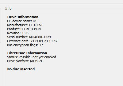

#3744 Post by babayaga » Sat Apr 18, 2026 3:28 pm
Can BU40N (HL-DT-ST_BD-RE_BU40N_1.05) be firmware flashed with mk1.03, when the revision on Verbatim drive is 1.05?
From what i understand by reading the guide, is that there are no reason to flash it several times or make a backup of the current firmware, you just flash the DE_LG_BU40N_1.03_MK.bin firmware and that's it? With mk-firmware-pack-20200720 in the sdftool, i find many BY40N firmwares, but which to chose from? is this the correct one? HL-DT-ST-BD-RE_BU40N-1.04-NM00500-212005061142.bin?

#3747 Post by babayaga » Sat Apr 18, 2026 6:56 pm
babayaga wrote: Sat Apr 18, 2026 3:28 pm Can BU40N (HL-DT-ST_BD-RE_BU40N_1.05) be firmware flashed with mk1.03, when the revision on Verbatim drive is 1.05?
So the trick was to only flash DE_LG_BU40N_1.03_MK.bin and everything worked, no more no less, it's a bit hard to understand sometimes in this forum, what you should actually do, and the guide can be a bit misleading i think. And what about the HL-DT-ST-BD-RE_BU40N-1.04-NM00500-212005061142.bin that is included with the flasher? is this a newer iteration of the 1.03MK firmware or just a original 1.04 firmware?

RubberDuckTruck wrote: Sat Apr 18, 2026 5:20 pm Ok, so I have the controversial? LG BP50NB40 NB52.
I thought I read the recommended firmware for this was BU40N 1.00 in a recent (Jan 2026ish?) post from MartyMcNuts. I can't seem to find that comment anymore. Followed the guide, watched the BP50NB40_CF.gif and everything seemed to be working fine until I noticed a 4K UHD disc came out as 1080p once ripped.
Does this drive, once flashed, enable reading UHD but can only output to 1080p? Did I miss that? I now see it now says "UHDofficialish" and I don't remember seeing that either. I tried a recovery flash from BU40N 1.00 to BP60N 1.00. With this recent flash to BP60N 1.00 the test rip is still outputting to 1080p.
If this is the "limitation" of this drive I'm ok with that, especially since things are the way they are right now. Or, did I do something wrong? I'll include the info MakeMKV is currently reading from the drive. If you can tell from the info that something is amiss I'd appreciate the steps to correct it and put it to it's recommended firmware given it's current state. I have the All You Need Firmware Pack and the SDFtool Flasher v1.3.6.
I also noticed that MakeMKV projected another rip as 27.5 GB but came out at 23.5 GB? My hope is that I didn't mess something up permanently.
Nothing controversial about the BP50NB40 drive. Works fine, and if you can rip a 4K/UHD disc, then you flashed it successfully.
The drive/firmware has nothing to do with the resulting file resolution (1080p). MakeMKV nor the drive modify the resolution of the video you rip. The source disc & video/playlist *YOU* choose determines the resolution. If the MKV file produced is 1080p, then that is the resolution of the disc/video you ripped. If it's a multi-disc set, make sure you are ripping the 4K disc & not the Blu-ray Disc.
There are no "limitations" of your drive. From the MakeMKV info you posted, it looks like you flashed the firmware correctly.
"projected" file size vs. rip file size is not relevant. "projected" (wherever you are seeing that) is probably the entire playlist/stream, including all languages & all sound tracks. *You* determine which languages/soundtracks you want included & that determines the ultimate file size of the rip.

#3749 Post by tomty89 » Sun Apr 19, 2026 1:23 am
babayaga wrote: Sat Apr 18, 2026 6:56 pm So the trick was to only flash DE_LG_BU40N_1.03_MK.bin and everything worked, no more no less, it's a bit hard to understand sometimes in this forum, what you should actually do, and the guide can be a bit misleading i think. And what about the HL-DT-ST-BD-RE_BU40N-1.04-NM00500-212005061142.bin that is included with the flasher? is this a newer iteration of the 1.03MK firmware or just a original 1.04 firmware?
Files in the MK firmware pack are all MK firmware. An MK firmware is just an original firmware of the same version number that has been patched in some way, so when there is a more updated original firmware, there's a chance that mike could patch it and update the pack.
(Note really sure what DE_LG_BU40N_1.03_MK.bin is.)
... If your drive has one of these firmwares, and there is no MK version of the same firmware/drive model or higher number, you will have to sidegrade to ... or (BU40N 1.03MK LG Slim drives ONLY) ...
But I have to admit that I'm also not sure whether there's something "special" about HL-DT-ST-BD-RE_BU40N-1.03-NM00000-211810241934.bin, or if it's just that "The all you need firmware pack" and the guide didn't catch up with it when the MK firmware pack got updated...
P.S. The thing is being more updated does not necessarily means the firmware is better, especially when it comes to UHD capability / ripping compatibility / ... (what people here mainly concern). Also maybe whoever maintains the guide / all you need pack follows the "not broken don't fix it" policy (while mike just tried his best in MK-ising the relevant original firmware when new versions showed up).

#3750 Post by MartyMcNuts » Sun Apr 19, 2026 1:34 am
tomty89 wrote: Sun Apr 19, 2026 1:23 am
But I have to admit that I'm also not sure whether there's something "special" about HL-DT-ST-BD-RE_BU40N-1.03-NM00000-211810241934.bin, or if it's just that "The all you need firmware pack" and the guide didn't get updated when mike updated the MK firmware pack...
BU40N 1.03-MK is the better version and is what is recommended. Newer does not equal better!
