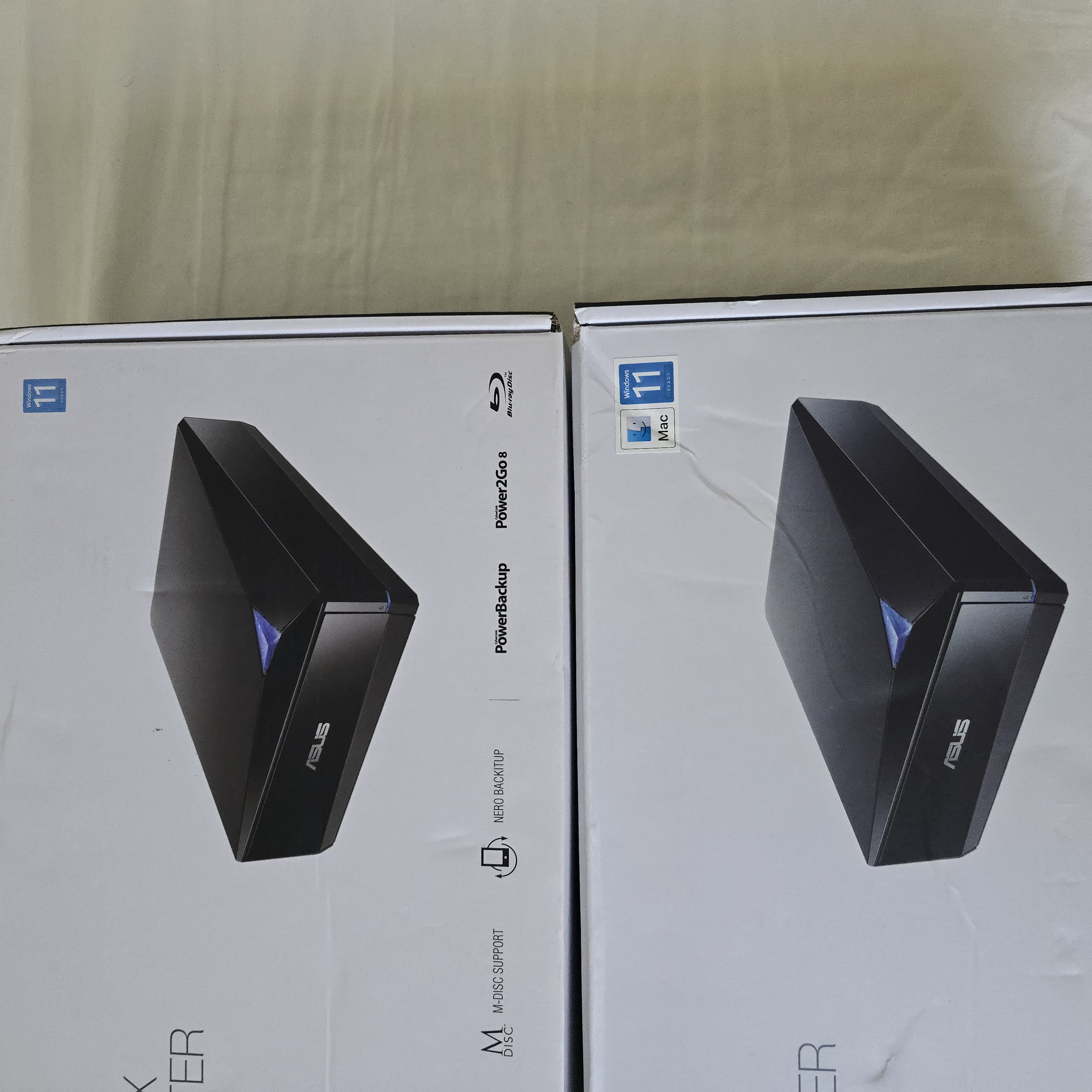

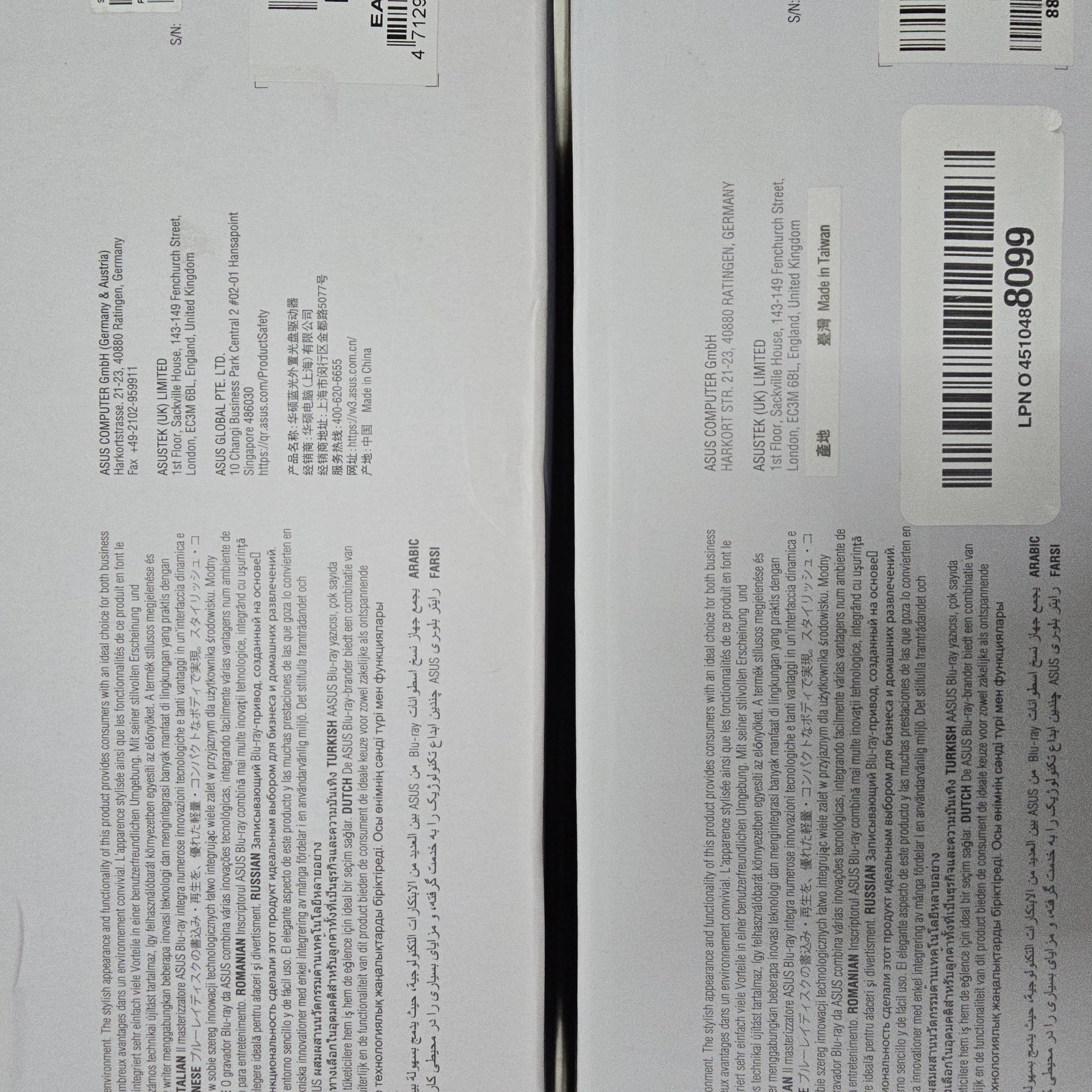

This is a observation. I noticed while looking at both ASUS BW‑16D1X‑U boxes one with LG BH50N / LG BH16NS40 the box color is white with slight purple tint - only has the windows 11 logo on the front. While the one with Pioneer 212t the box color is white - Mac OS and Windows 11 logo on front and side where the serial number is has a sticker made it Taiwan. Both have the same built year.
