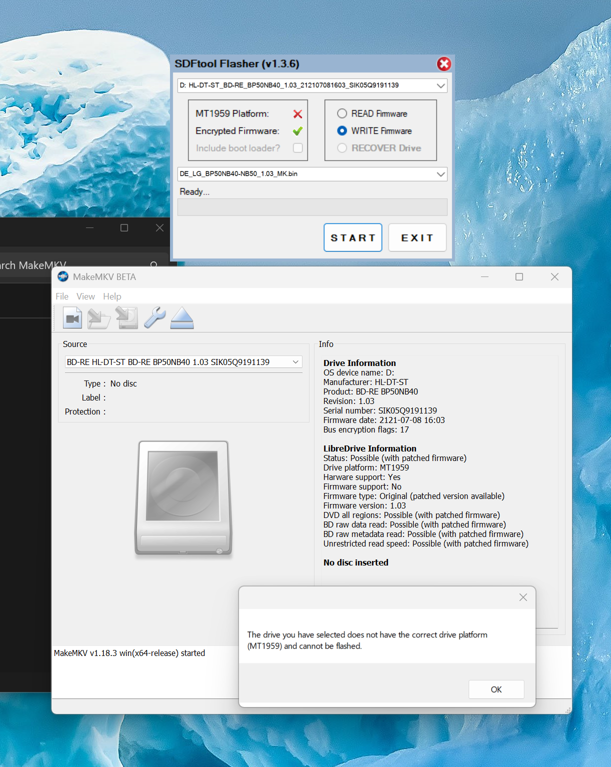

#1684 Post by mfann6619 » Wed Apr 01, 2026 4:52 am
Why am I getting this error? How can I resolve this?
Screenshot 2026-04-01 005015.png (1.14 MiB) Viewed 11485 times
Posts: 4983
Re: SDFtool Flasher
#1685 Post by MartyMcNuts » Wed Apr 01, 2026 10:37 pm
mfann6619 wrote: Wed Apr 01, 2026 4:52 am Why am I getting this error? How can I resolve this?
Are you using a real windows 11 64 bit PC or some sort of VM?

mfann6619
Joined: Wed Apr 01, 2026 4:48 am
Re: SDFtool Flasher
#1687 Post by mfann6619 » Wed Apr 01, 2026 11:25 pm
MartyMcNuts wrote: Wed Apr 01, 2026 10:37 pm
I am on a real Windows 11 64 bit PC. A Minisforum MS-01.

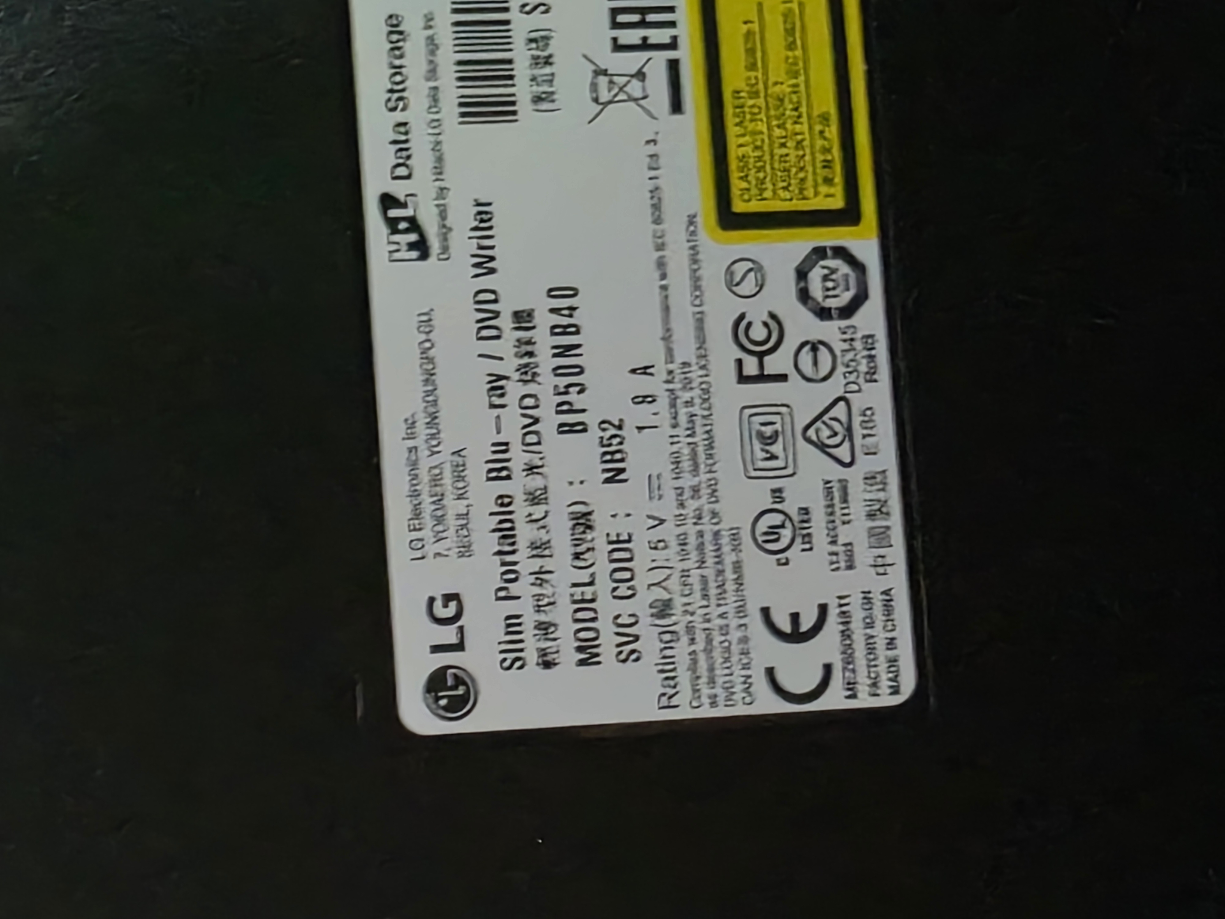

#1688 Post by MartyMcNuts » Thu Apr 02, 2026 1:57 am
mfann6619 wrote: Wed Apr 01, 2026 11:25 pm
What is the SVC code of your drive? It will be written on the label on the side of the box and also underneath the drive. If it is SVC NB72, it is not compatible.
mfann6619
Re: SDFtool Flasher
#1689 Post by mfann6619 » Thu Apr 02, 2026 2:29 am
MartyMcNuts wrote: Thu Apr 02, 2026 1:57 am
It is SVC NB52.
Posts: 6006
Re: SDFtool Flasher
#1690 Post by Billycar11 » Thu Apr 02, 2026 3:21 am
mfann6619 wrote: Thu Apr 02, 2026 2:29 am
It is SVC NB52.
run the flasher as admin
some windows 11 pcs hide drive info from stuff
seen this with the pioneer flasher
mfann6619
Re: SDFtool Flasher
#1691 Post by mfann6619 » Thu Apr 02, 2026 4:38 am
Billycar11 wrote: Thu Apr 02, 2026 3:21 am
It is SVC NB52.
Still no good.
