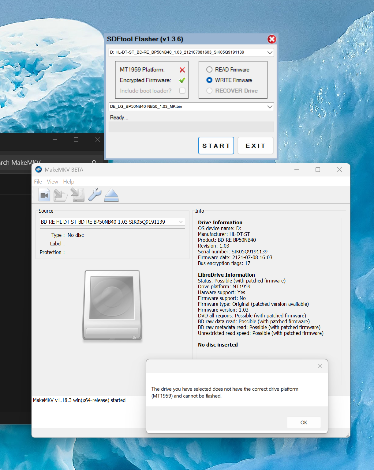

Why am I getting this error? How can I resolve this?

Are you using a real windows 11 64 bit PC or some sort of VM?mfann6619 wrote: Wed Apr 01, 2026 4:52 am Why am I getting this error? How can I resolve this?

I am on a real Windows 11 64 bit PC. A Minisforum MS-01.MartyMcNuts wrote: Wed Apr 01, 2026 10:37 pmAre you using a real windows 11 64 bit PC or some sort of VM?mfann6619 wrote: Wed Apr 01, 2026 4:52 am Why am I getting this error? How can I resolve this?

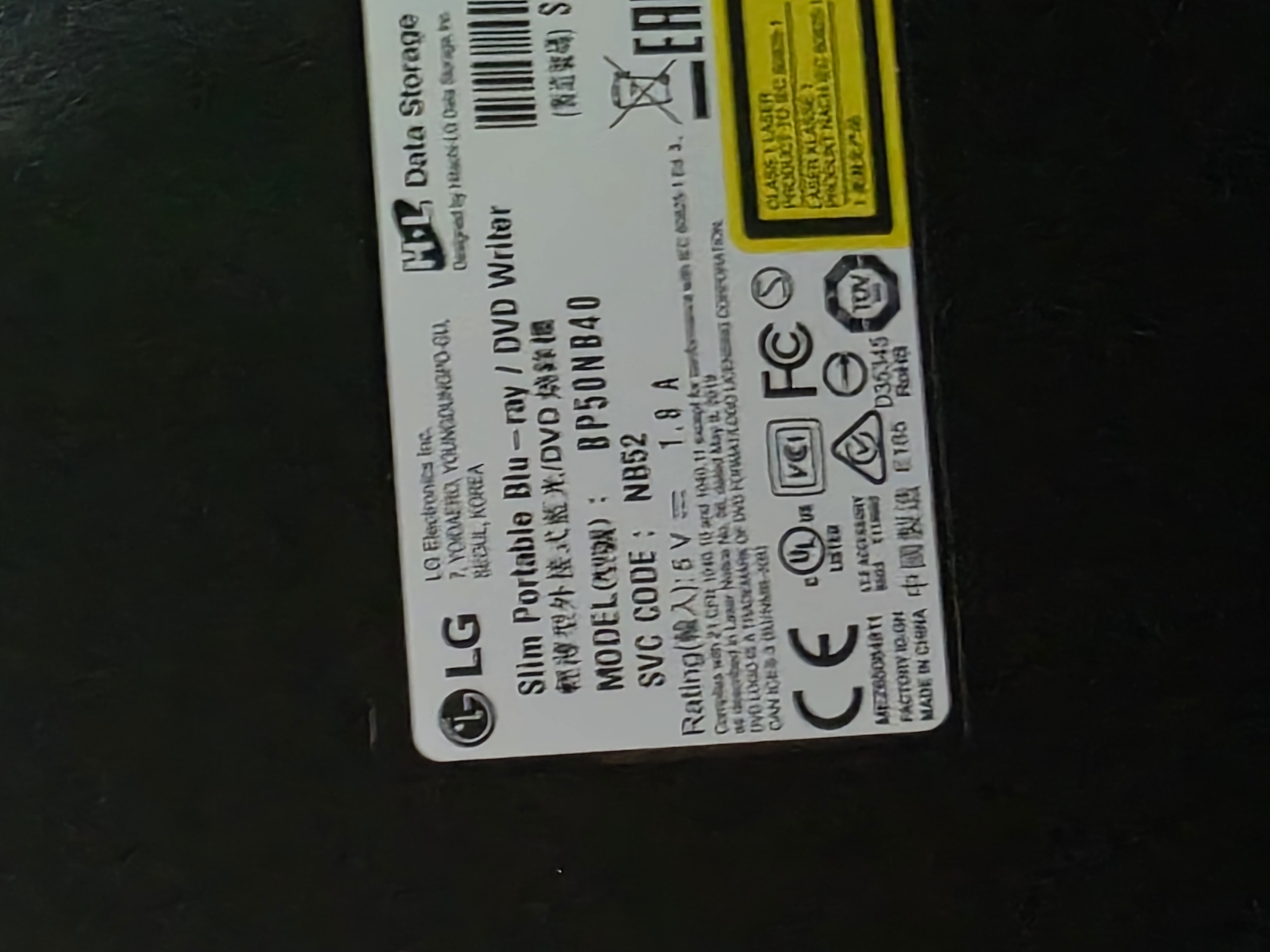

What is the SVC code of your drive? It will be written on the label on the side of the box and also underneath the drive. If it is SVC NB72, it is not compatible.mfann6619 wrote: Wed Apr 01, 2026 11:25 pmI am on a real Windows 11 64 bit PC. A Minisforum MS-01.MartyMcNuts wrote: Wed Apr 01, 2026 10:37 pmAre you using a real windows 11 64 bit PC or some sort of VM?mfann6619 wrote: Wed Apr 01, 2026 4:52 am Why am I getting this error? How can I resolve this?

It is SVC NB52.MartyMcNuts wrote: Thu Apr 02, 2026 1:57 amWhat is the SVC code of your drive? It will be written on the label on the side of the box and also underneath the drive. If it is SVC NB72, it is not compatible.mfann6619 wrote: Wed Apr 01, 2026 11:25 pmI am on a real Windows 11 64 bit PC. A Minisforum MS-01.MartyMcNuts wrote: Wed Apr 01, 2026 10:37 pm

run the flasher as adminmfann6619 wrote: Thu Apr 02, 2026 2:29 amIt is SVC NB52.MartyMcNuts wrote: Thu Apr 02, 2026 1:57 amWhat is the SVC code of your drive? It will be written on the label on the side of the box and also underneath the drive. If it is SVC NB72, it is not compatible.
some windows 11 pcs hide drive info from stuff

Still no good.Billycar11 wrote: Thu Apr 02, 2026 3:21 amrun the flasher as adminmfann6619 wrote: Thu Apr 02, 2026 2:29 amIt is SVC NB52.MartyMcNuts wrote: Thu Apr 02, 2026 1:57 am
