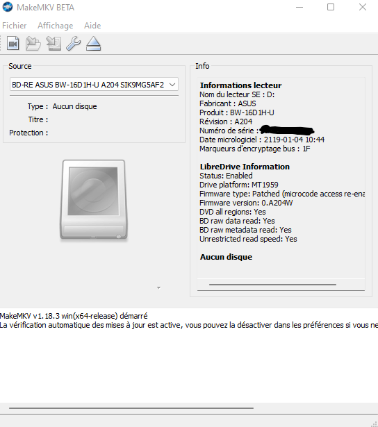

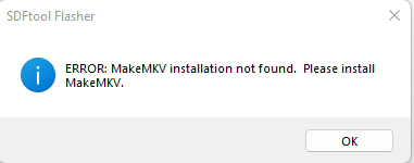

Hi everybody,
First, thank you for your work on this. I own an external BD burner ASUS BW-16D1H-U PRO usb and I downloaded the latest SDFtool Flasher, it asked me the MakeMVV file, but i didn't find it on the main post, unless I missed something...Do you know where I can download it please ?

Maskman wrote: Sun Mar 29, 2026 4:38 pm Hi everybody,
First, thank you for your work on this. I own an external BD burner ASUS BW-16D1H-U usb and I download the latest SDFtool Flasher, but it ask me the MakeMVV file, but i diddn't find it on the main post, unless I missed it...Do you know where I can download it pleae ?
https://www.makemkv.com/download/

d00zah wrote: Sun Mar 29, 2026 4:52 pm
Thanks, found it and installed it. Which Firmware is compaible with my drive please ?
LG WH16NS60 1.02-MK is the recommended firmware for your drive. Another option is the ASUS BW-16D1HT 3.10-MK firmware but it does read a bit slower and does not remove the UHD disc sleep bug.
Thank you very much :)
I see the HL-DT-ST-BD-RE_WH16NS60-1.03-N000600-212005081010.bin, not the 1.02-MK in the main page….
