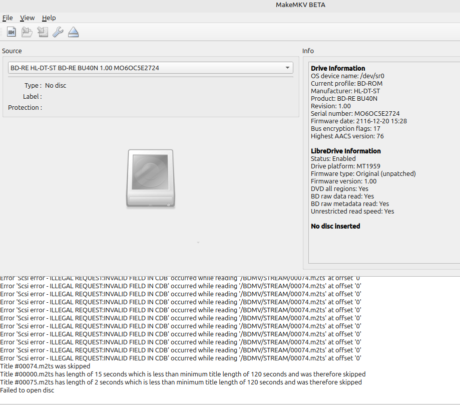

Billycar11 wrote: Thu Mar 19, 2026 3:41 am
farmboy wrote: Thu Mar 19, 2026 3:07 am
still having an error. switched to a desktop so there is better power available. Got it so it doesn't randomly disconnect. But will still fail. Screenshot below. There is an error that comes up about "downloading latest HK disabled or failed". Not sure if that is relevant? 1st time it tried to download that, it just sat there a while and failed.
you still likely have a power issue if the dive is showing no disc in the middle of trying to open it
try a high powered usb hub 35+ watts
oh wait your on linux downgrade to 1.00 then try again
no luck on 1.00 either.
Going to walk away from this tonight.
So, what is a recomended external drive for ripping 4K UHD movies?
Posts: 6029
farmboy wrote: Thu Mar 19, 2026 3:55 am
no problem
i only recommend pioneers but they are near impossible to find at a reasonable price my favorite drive is the xd08b/s/g
never get the tc one thats fake.
you still may have a power issue as is disconnecting right away right at 0 get your self a high powered usb hub 35+ watts and try again
defiantly do not get the archgon as for now it does not work for flashing or reading in the case

farmboy
Joined: Tue Mar 10, 2026 12:47 am
Post by farmboy »
nicholfd wrote: Thu Mar 19, 2026 3:41 am "HK Download" error - MakeMKV needs internet access to download keys. It is enabled by default. Check internet or confirm setting in MakeMKV allows Internet access. I *think* some downloads are from Russia(?) - make sure your FW/router is not blocking Regional IP addresses.
Download failure is not related to the SCSI error messages - those are still power related.
Desktop does not necessarily equal better power.
Use a "Y" cable w/2 x USB port connections, AC adapter (if chassis supports it), or a good, high amp output USB hub.
can you point to a specific "Y" cable?
I've tried a few different types, but the ones I've gotten only allow power and data from the side with 1 connection (Side A) to either cable on the two cable side (Side B). Meaning that I cannot connect the the drive to side A, and have one cable on side B go to the computer and the other go to my 65W output USB-C. The power won't go from side B to side A. And it appears to be isolated so I can't send power across the two side B cables.
(hopefully this makes sense). I'm not finding a way to supply power AND data to the drive via two different sources.
nicholfd
Posts: 367
Post by nicholfd »
farmboy wrote: Fri Mar 27, 2026 10:49 pm
The "Y" cables have "specific" ends. Here is a 2 x USB-A -> USB-C cable I've used & include with my Verbatim drives I have for sale: cablecc USB-C Male & USB 2.0 Dual Power Data Y Cable for Laptop & Hard Disk.
The thinner cabled USB-A is power only. The thicker USB-A is power & data. The USB-C end is for the drive, and you'd have to buy a "Y" cable with the same connector type on this end, to match what is on your USB chassis/drive (I don't recall if you listed what is on your USB drive chassis). The above linked cable has options on the product page for various chassis/drive ends of the cable.

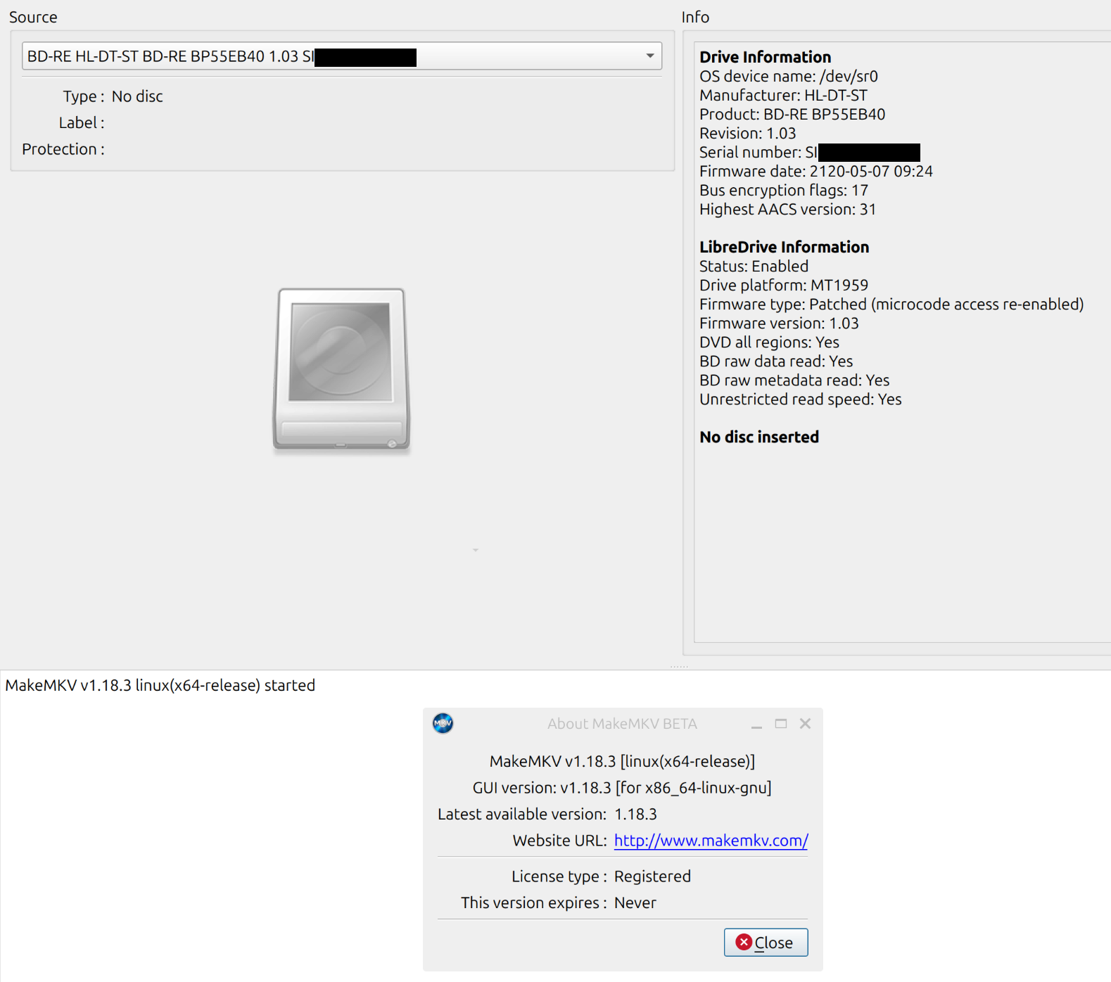

Simmr
Joined: Sat Mar 28, 2026 5:00 pm
Post by Simmr »
Thanks for the extensive guide and provided ressources. I've been using MakeMKV for some years now and it's been great.
Some time ago I patched my drive (BP55EB40) but just now got my hands on a UHD disk to try ripping that. The drive is searching the disk for about 2 minutes and then MakeMKV shows no disk inserted.
Is this related to the sleep error? How can I fix this?
The screenshot is from Linux but I am experiencing the same behavior on Windows and with another disc too. FHD Blu rays can be ripped without any problem at up to 6x speeds from what I've seen so far.
Thanks in advance!
The same error exists on Win11

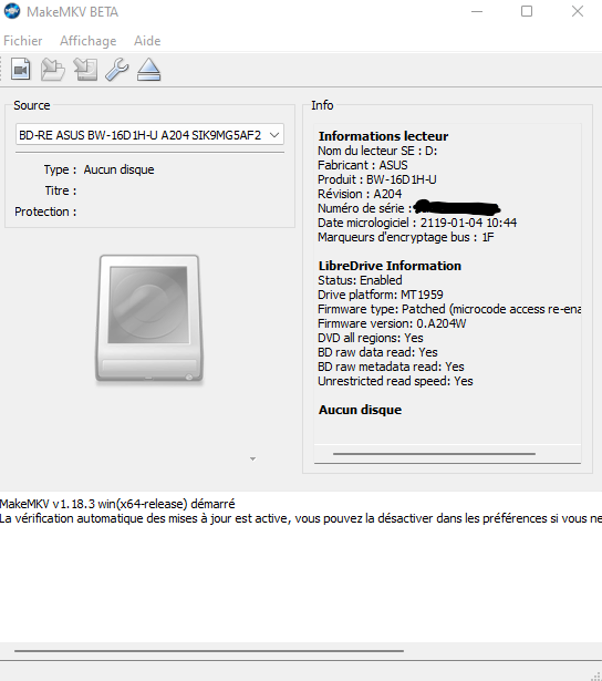

Which firmware for the ASUS BW-16D1H-U PRO please ? I also have issue with Nero Burning rom (a better software ?) which doesn’t detect my device :? maybe need a driver I don’t have, just the default Windows one.
Thanks.
Posts: 6029
Maskman wrote: Sun Mar 29, 2026 10:15 pm Hi,
Thanks.
Flash to wh16ns60

Maskman
Joined: Sun Mar 29, 2026 4:25 pm
Post by Maskman »
Billycar11 wrote: Mon Mar 30, 2026 1:51 am
Thanks.
Flash to wh16ns60
Thanks ! Which version please ? There is different versions of wh16ns60.
Posts: 6029
Maskman wrote: Mon Mar 30, 2026 10:18 pm
Thanks.
Flash to wh16ns60
I recommend 1.02 or 1.00
