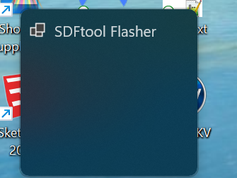

I just downloaded the tool but does not show up correctly on my windows 11 machine. It appears that the windows is too small and I can not see the check marks and the text is cutoff. Windows will not let me make the window bigger.
Screenshot 2026-03-18 172559.png (17.68 KiB) Viewed 34401 times

sgibbers17 wrote: Wed Mar 18, 2026 10:39 pm I just downloaded the tool but does not show up correctly on my windows 11 machine. It appears that the windows is too small and I can not see the check marks and the text is cutoff. Windows will not let me make the window bigger.
From the first post.
NOTE: If the GUI looks a bit deformed (happens on a 4k monitor), you can right click the exe and select properties. In the compatibility tab, click "Change high DPI settings" then under "High DPI scaling override" tick the box and select "System (Enhanced)" in the dropbox.

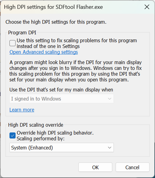

1. right click the exe
2. select properties
3. In the compatibility tab, click "Change high DPI settings"
4. under "High DPI scaling override" tick the box and select "System (Enhanced)"
5. click apply and close this window
6. Now run the exe.

What?!?
6. Now run the exe.

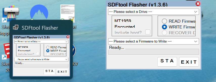

This is a screenshot of before settings are changed.
Screenshot 2026-03-18 182549.png (152.92 KiB) Viewed 34311 times
Screenshot of my settings
Screenshot 2026-03-18 182705.png (36.82 KiB) Viewed 34311 times
what it looks like with the new settings.
Screenshot 2026-03-18 182735.png (85.21 KiB) Viewed 34311 times

Wow, never seen that happen before! Just download the old original from the first post and use that. It should look correct.
