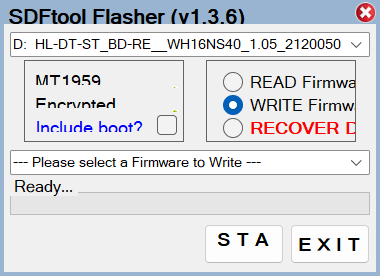

I just downloaded the tool but does not show up correctly on my windows 11 machine. It appears that the windows is too small and I can not see the check marks and the text is cutoff. Windows will not let me make the window bigger.
Screenshot 2026-03-18 172559.png (17.68 KiB) Viewed 42444 times

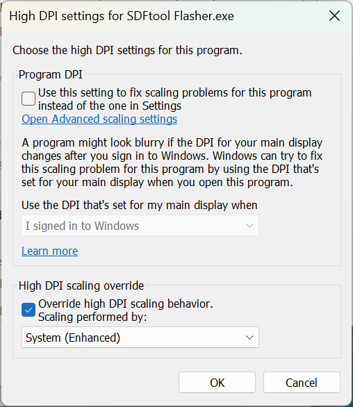

1. right click the exe
2. select properties
3. In the compatibility tab, click "Change high DPI settings"
4. under "High DPI scaling override" tick the box and select "System (Enhanced)"
5. click apply and close this window
6. Now run the exe.

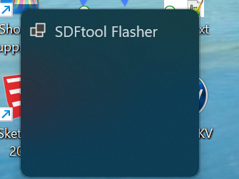

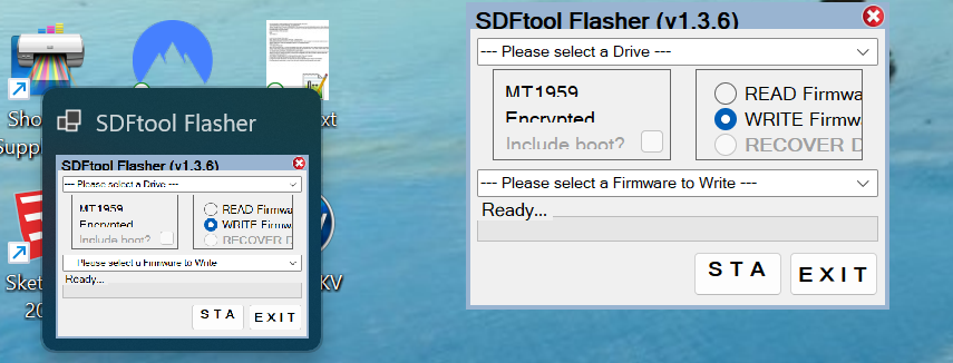

This is a screenshot of before settings are changed.
Screenshot 2026-03-18 182549.png (152.92 KiB) Viewed 42354 times
Screenshot of my settings
Screenshot 2026-03-18 182705.png (36.82 KiB) Viewed 42354 times
what it looks like with the new settings.
Screenshot 2026-03-18 182735.png (85.21 KiB) Viewed 42354 times
